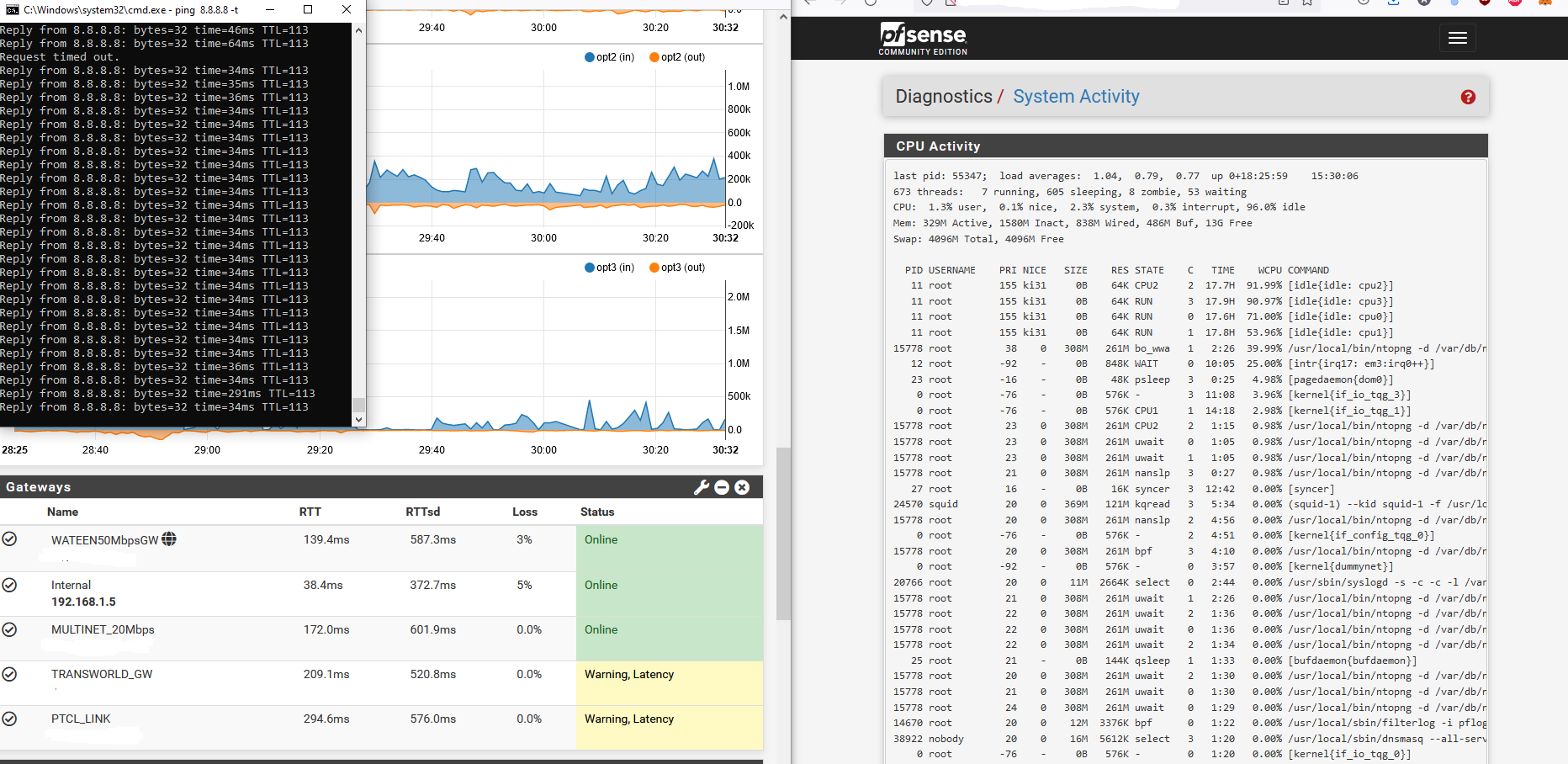

                          @Silence , @stephenw10 Facing this issue again. Can you guys please help me out to resolve this issue.
                            I assume you were not seeing the same 60% total CPU usage when that shot was taken?
                            The only thing of any significance there is ntop-ng. You might try disabling that as a test.

                              @stephenw10 Yes after restarting I am not seeing 60% of CPU utilization. OK thanks I will stop the ntopng and than check if this work than I will find any way around for this.
