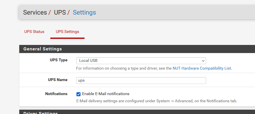

Hi everyone, I've just configured telegram notifications, but I don't receive every alert that instead are being sent via smtp.
For example I correctly receive dns updates and WANs (dis)connections on both mail and telegram, but ups notifications are not being sent via telegram.
Am I missing something?
@samlink said in What notification can be sent thru telegram?:
Am I missing something?Yes.
This :
The (NUT) UPS package only knows how to send 'mail' aka smtp_send.
It hasn't been made aware of the fact that other notifications methods exist these days.A support request is already in place : [see here](Add support for Telegram/Pushover notifications).

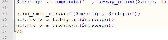

If you are willing to edit a file :
Add these at the bottom of /usr/local/pkg/nut/nut_email.php :
notify_via_telegram($message); notify_via_pushover($message);It should now look like :
if telegram and/or pushover are set up, notices will get send to them.
Test : cut the power of the UPS.
@gertjan >It works flawlessly. Thanks!
