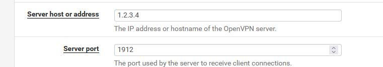

          A possible solution :
          Look up the IP of "myvpnprovider.com" yourself :
          host myvpnprovider.com
          and use the IP found here :
