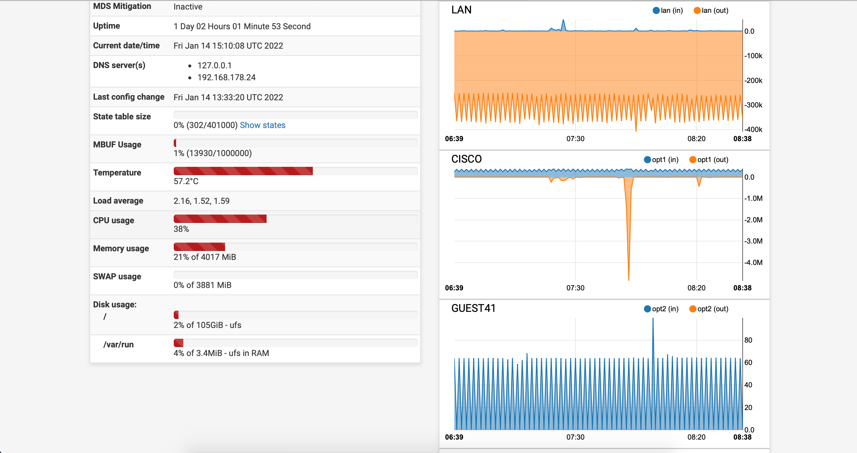

      There are no devices connected to Guest41 VLAN, yet there are 64 B/s spikes recorded in the traffic graph for this interface. These spikes appear to be occurring in the other interfaces also. I’ve tried disconnecting various devices from the network to identify the source without success.
      I’ve used pfTop and ntopng, but can’t identify the source of these packets (possibly due to my inexperience, and not knowing how to correlate the traffic graphs with the outputs from these analysis programmes).
      I’d like to find out the source of this network activity…does anyone have any idea what would be causing this and how I might find out?
      Many thanks

        @monkey-music Those probably are pings, perhaps from the managed switch you presumably are using to distribute ports to your VLANs. Try a packet capture (diagnostics/packet capture) on the Guest41 VLAN interface (select it under "interface") on the packet capture page. Select "full" under "level of detail" and run the capture for a few minutes. Then stop it and look at the packets. If they're pings, they'll be type ICMP echo request/reply.

          @bpsdtzpw Thank you for helping. You are correct, I have a managed switch distributing ports to the VLANS with trunked ports connected to the pfSense router and WAPs.
          The packet capture has revealed packets being sent every 2 seconds, and all appear identical to what's pasted below:
          21:46:50.327589 00:1d:e6:ef:b5:09 > 01:00:0c:cc:cc:cd, 802.3, length 50: LLC, dsap SNAP (0xaa) Individual, ssap SNAP (0xaa) Command, ctrl 0x03: oui Cisco (0x00000c), pid PVST (0x010b), length 42: STP 802.1d, Config, Flags [none], bridge-id 8029.00:1d:e6:ef:b5:00.8009, length 42
          message-age 0.00s, max-age 20.00s, hello-time 2.00s, forwarding-delay 15.00s
          root-id 8029.00:1d:e6:ef:b5:00, root-pathcost 0
          As you suggested, the packets do seem to be originating from the managed switch. I was not aware of this behaviour on the network previously. The only recent change I made to the network was to add another VLAN with a single wired port for an IP camera (with firewall rules to block WAN access and access to LAN and other VLANS).
          Any idea about what I should do next?
