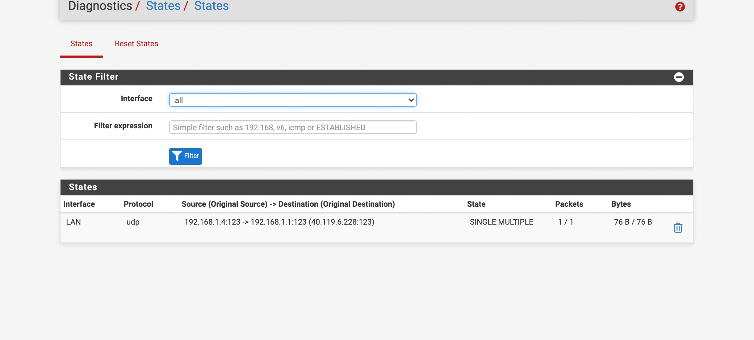

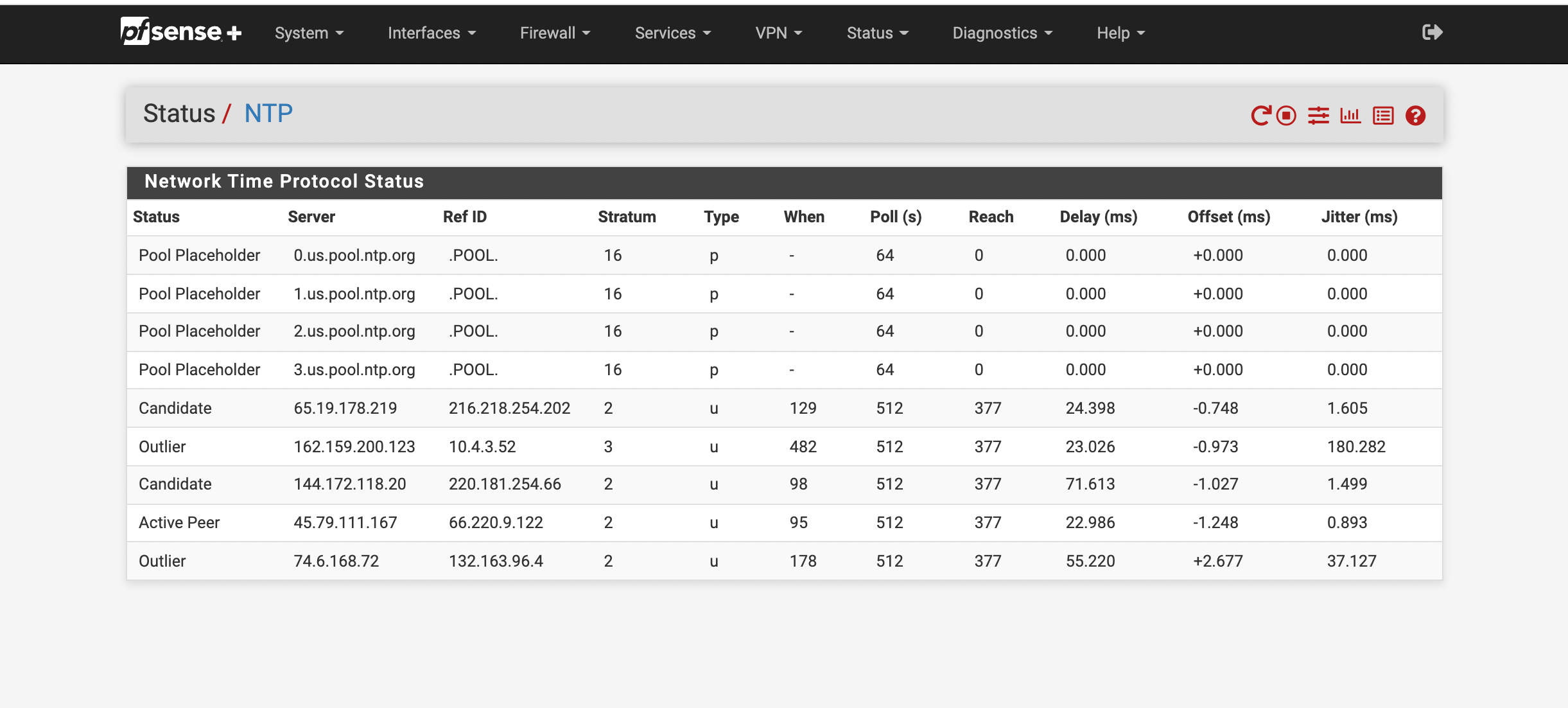

                      The goal for me is any lan device that is on my network that wants to use NTP port 123 have the NAT network address translation redirect that request so it will pull time only from the firewall on 192.168.1.1:123. The destination will always be different if you have not manually set your time servers on each device on your lan network. This takes that manually configuring each device out of the equation. Each system when it wants a time update will send a request to i.e. Windows timer server or Apple's time server etc, The firewall will intercept that request and change it so that the firewall will be the one to send the reply with the time update. Netgate's pfSense can have many time servers, it will even take and auto adjust time based on the how many servers you have included in your time pool. So if jitter or stratum changes occur the firewall will still be as close to the atomic clock as possible because of the math based auto adjustments built into the firewall.

                      (Image: Time Pool and you can see the offsets, stratum number)
                      Please Check your state when time is issued to make sure you have a redirect running and not a WAN address. This show the request was made from a source, what was the original request, as well as the overide or redirect that issued the time.
