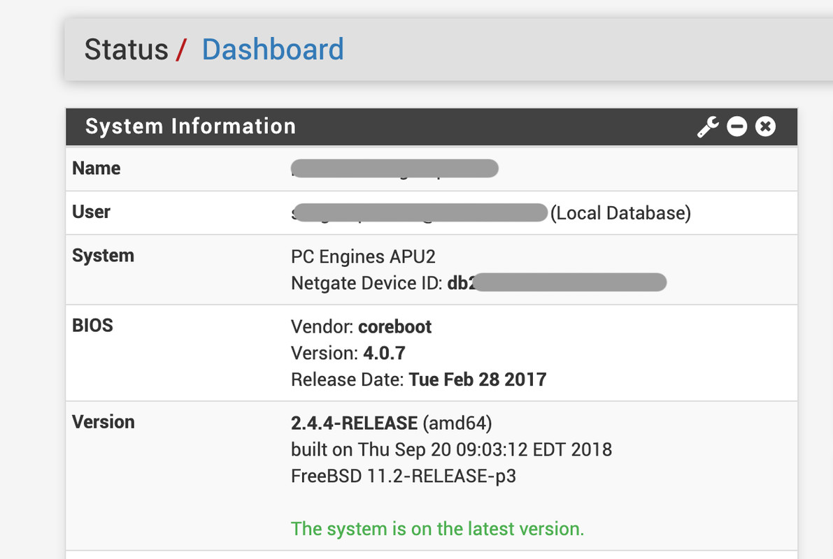

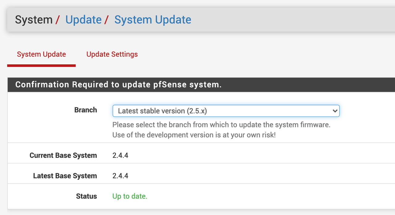

      Hello,
      I have a pfSense in version 2.4.4, and it tells me that: "The system is on the latest version".
      Same thing if I go to the "System" menu then "Update": it tells me that I am on the latest version.
      I have selected the Branch "Last stable version 2.5.x"
      alt text
      alt text
      Why do you think it is up to date in 2.4.4? I have already restarted pfSense but it does not change anything
      thanks for your help

            SteveITS Galactic Empire @fabiensch
            @fabiensch said in pfSense said 2.4.4 is "on the latest version"...:
            Shared object "libarchive.so.7" not found, required by "pkg"
            This sounds like you installed a package from a version/repo newer than your pfSense. (per https://redmine.pfsense.org/issues/11452 and my sig).
            "Another instance is already running" sounds like it's already running an update. If you've waited a while you might try restarting.
            Worst case you can reinstall pfSense and restore the config from backup.
