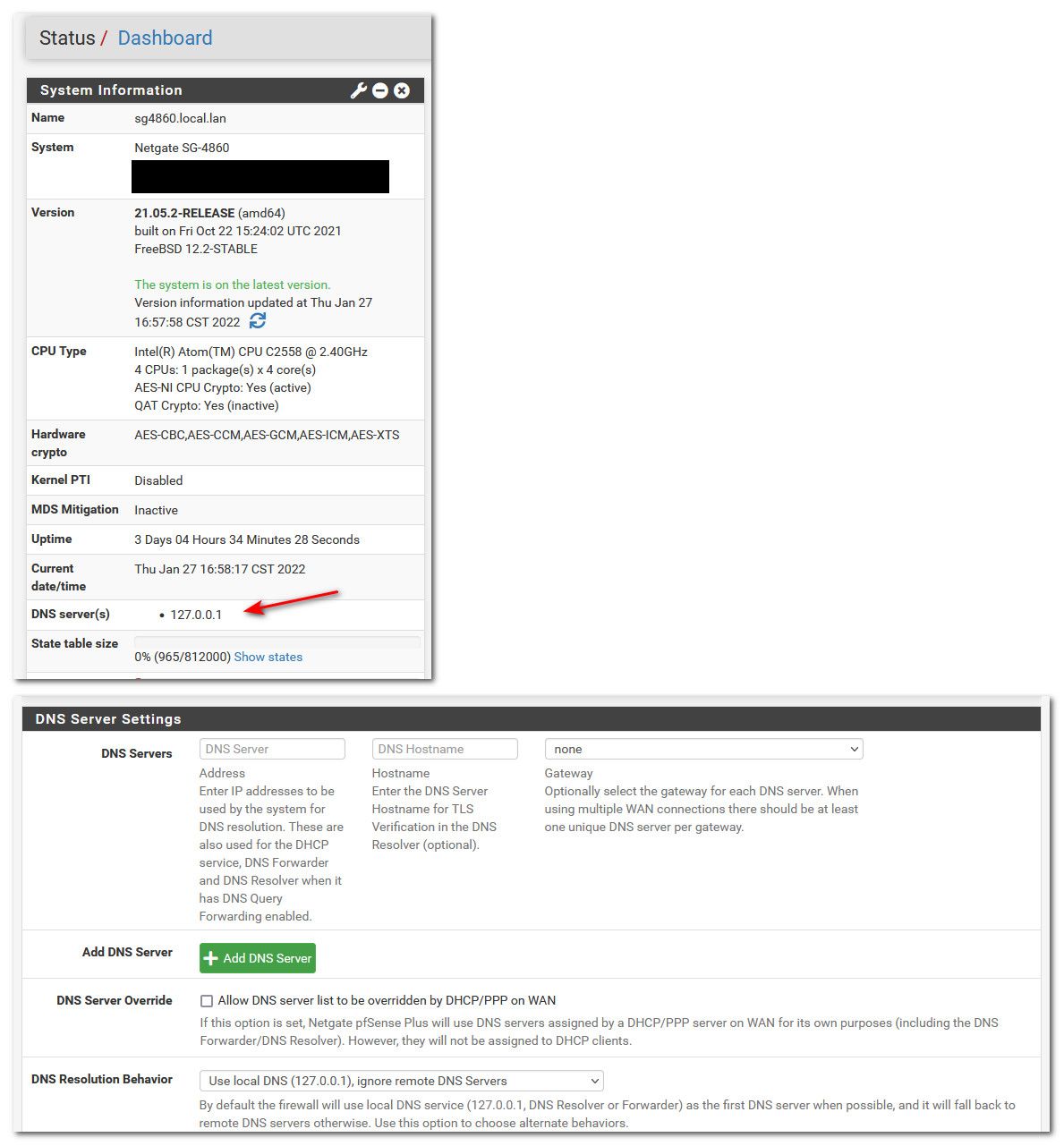

        Your setup page dns listed really has zero to do with what dns you hand to a client.. Those are dns servers that pfsense itself could use, or which could be used when unbound set to forwarding.. That have zero do with some client on your network and what name servers it has listed. If the NSs it has listed fail to answer then dns would fail its that simple.

            @coffeecup25 out of the box unbound resolves.. A client on your network ask unbound - it then via roots finds the authoritative nameserver for the domain your looking for. It cares nothing of the servers you have listed in pfsense dns. I have zero for example.
            Once it has found the authoritative ns for the domain.tld your looking for it then asks one those ns for the fqdn your looking for host.domain.tld
            What you have in general has zero to do with a client on your network asking pfsense (unbound) for something. Be that actual client, or a pihole you have setup on your network forwarding to pfsense.
            Those are only used by pfsense itself, ie looking for if there is an update (if unbound fails or is not running) - finding the server to look to see if there are packages, etc. Or if you have setup unbound to forward, it will then use the pfsense setup dns to forward too, etc.
            Normally out of the box, pfsense just ask itself (unbound) to resolve what it is looking for.. There normally never needs to be anything setup in general dns. Unless you have a problem resolving and setup unbound to forward, or you have not unchecked allow dns server list from your isp via your wan getting dhcp and your isp handing out dns to use. You will notice mine are unchecked.
