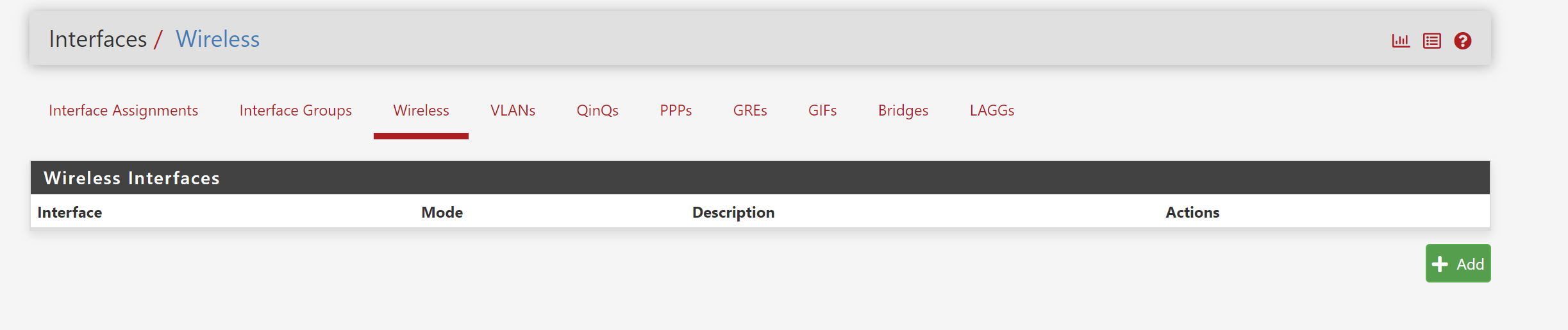

          msswift @stephenw10
          @stephenw10 I want to do that! But the device is not on the list of available interfaces. The output of ifconfig [given above] is the same list of (device) interfaces available in the console and web (user) interfaces. If there's a shell command I should do such as "ip link add link ..." then that is the information I am lacking. Momentarily will add usbconfig details which I forgot in first post.
            msswift @msswift
              msswift @msswift
              @msswift OK well, the little "add" button there is the trick. Thank you! I had been working from the command line and then only in the "interface assignments" page.
              I would like to know what is the command-line equivalent of the wireless "add interface" button does, for future understanding.
              thank you again,
              Matthew
