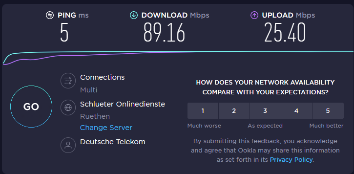

@stephenw10 i checked speedtest on both PCs (Linux Servers) in the Subnet 172.16.24.0/24:
Speedtest by Ookla Server: Contabo - Dusseldorf (id = 35154) ISP: Deutsche Telekom AG Latency: 5.59 ms (0.13 ms jitter) Download: 86.83 Mbps (data used: 85.5 MB ) Upload: 28.84 Mbps (data used: 21.3 MB ) Packet Loss: Not available.Speedtest by Ookla Server: Contabo - Dusseldorf (id = 35154) ISP: Deutsche Telekom AG Latency: 18.87 ms (0.57 ms jitter) Download: 87.27 Mbps (data used: 42.6 MB ) Upload: 29.15 Mbps (data used: 14.6 MB ) Packet Loss: Not available.Also on my PC in 192.168.178.0/24:
The routing between the networks just seems slow.
