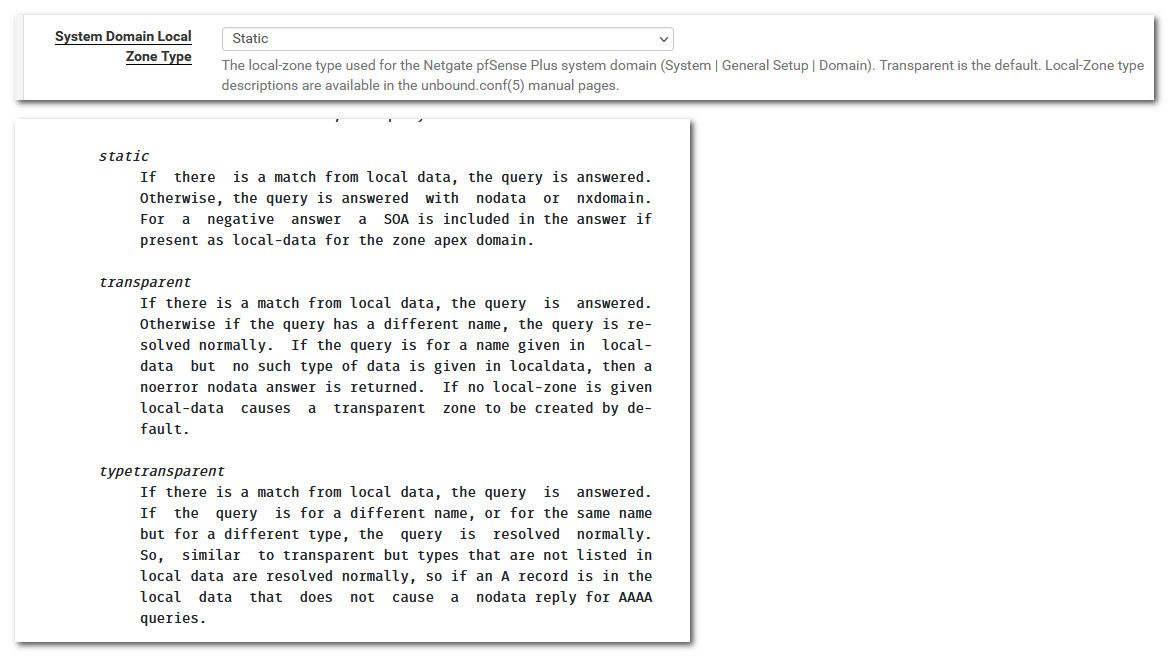

        • System Domain Local Zone Type was not correct setup. Was on redirect, should be Type Transparent
        • johnpozJ Online
          johnpoz LAYER 8 Global Moderator @Gamienator 0
          @gamienator-0 said in Setting up correct upstream DNS:
          depends - I have mine on static which to be honest I would think more people would want than transparent.
          Why would I my dns to go ask for something.local.lan if I do not have a record for it.. The only time you would want transparent is if your using same local domain that is public and you could have records in this domain that are resolved public etc..
          Normally you would want to be using a non public resolvable name for your local resources, the new home.arpa for example would never resolve public so why should your dns try resolve anything ever in that domain from roots or where you forward.. So static is the more appropriate setting in that case.
