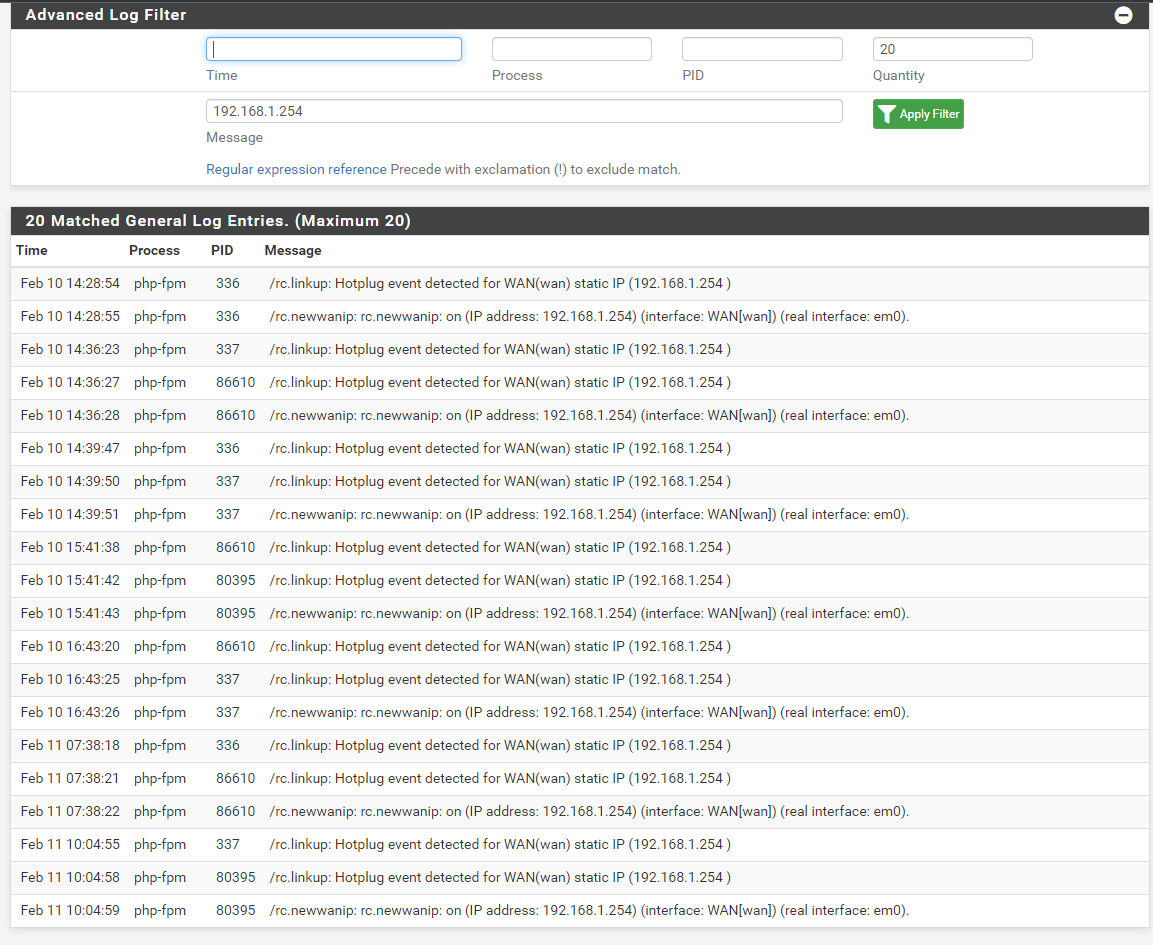

      all this works very well, now the problem is the following recently I began to notice that my openvpn is lost for a moment and then returns without me doing anything, checking in Status /System Logs /System /General I found this logs but I don't know what it means someone with more knowledge can intervene?
      Only One Interfaces.

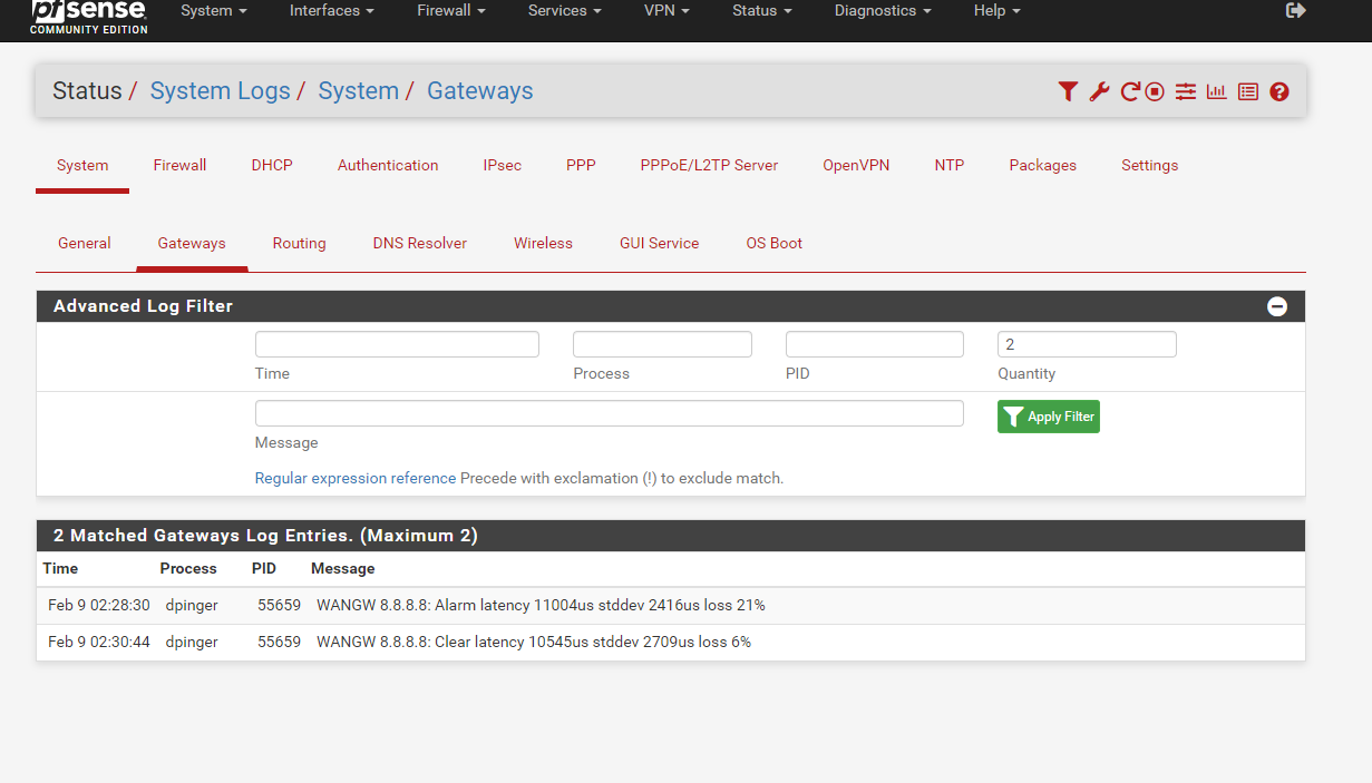

        Hmm, what I don't see there are associated em0 LINK state changed logs.
        Do you see anything in the gateway logs at those times?
        Are you running Snort/Suricata in in-line mode?
        Is the ISP router rebooting?
          Only this but they are outdated

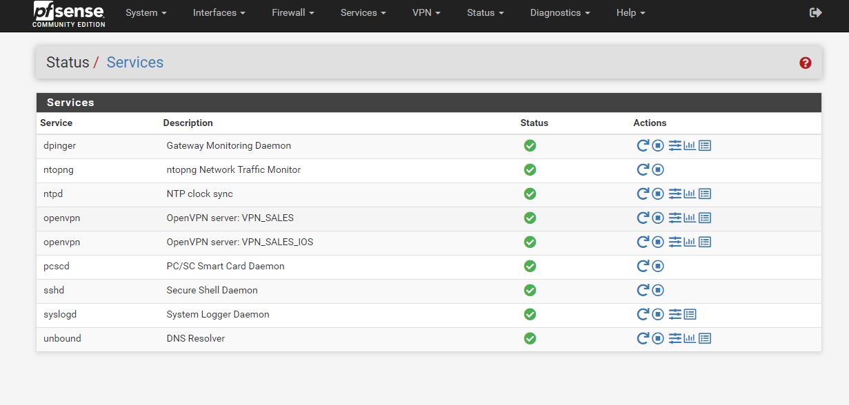

          My Services:
          My Dasboard:
            Hmm, ntop running on WAN (em0)? Can you disable that as a test?
