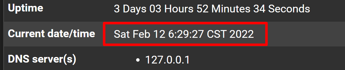

      Peculiar images attached. 2.5.2
      Today is 2/12/22 - 0630 CST

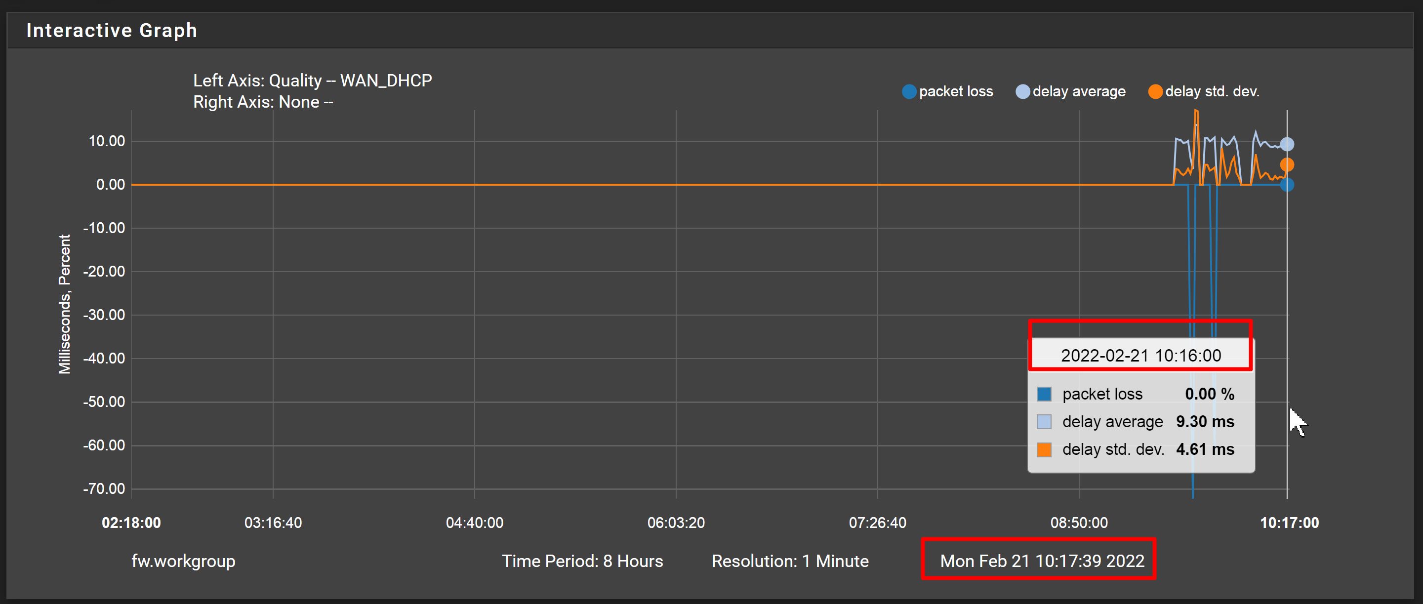

      Status/Monitoring shows wrong date - 2/21/21 - 1017.
      Dashboard show correct date/time and NTP status.

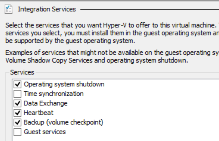

      FW is a VM on Win 2012R2, VM time sync NOT managed by host.

        Hmm, weird. Is it updating at the 21st end of that graph?
        I have seen some odd graphs when the RRD files have data from a bad system clock.
        provelsP 1 Reply Last reply Reply Quote 0
        • provelsP Offline
          provels @stephenw10
          @stephenw10 said in Oddness of Traffic Status, RRD Sumary and NTP...:
          Thank for mentioning that. No, it's stopped @ 1017, 2/12/22. Also, the RRD Summary usage is far below my actual so it's all completely wonky. Main reason I rebuilt it was that NTP didn't want to connect to the pools at reboot; I had to bounce it afterwards. Using pools 1/2/3/4.us.pool.ntp.org. Seems to start OK now, and I was thinking that maybe it didn't connect because Unbound was still in startup mode (using PFBNGdevel) after NTP had already started.

              Yeah, I realize that, but time service from the host is disabled. This may be entirely self-inflicted, but I've had similar RDD problems for a while.

                Yeah, this seems like a virtualisation issue. I don't use hyper-v so I can't comment specifically. But if this is not a new issue maybe try enabling time sync there?
                • provelsP Offline
                  provels @stephenw10
                  Thanks. I will, and I think I've read that host time sync is only for maintaining the VMs time when the VM is off, but conversely it doesn't seem the host should loop with the VMs NTP either. I'll give it a try and delete all the present RRD data since it's corrupt anyway. Thanks again.
