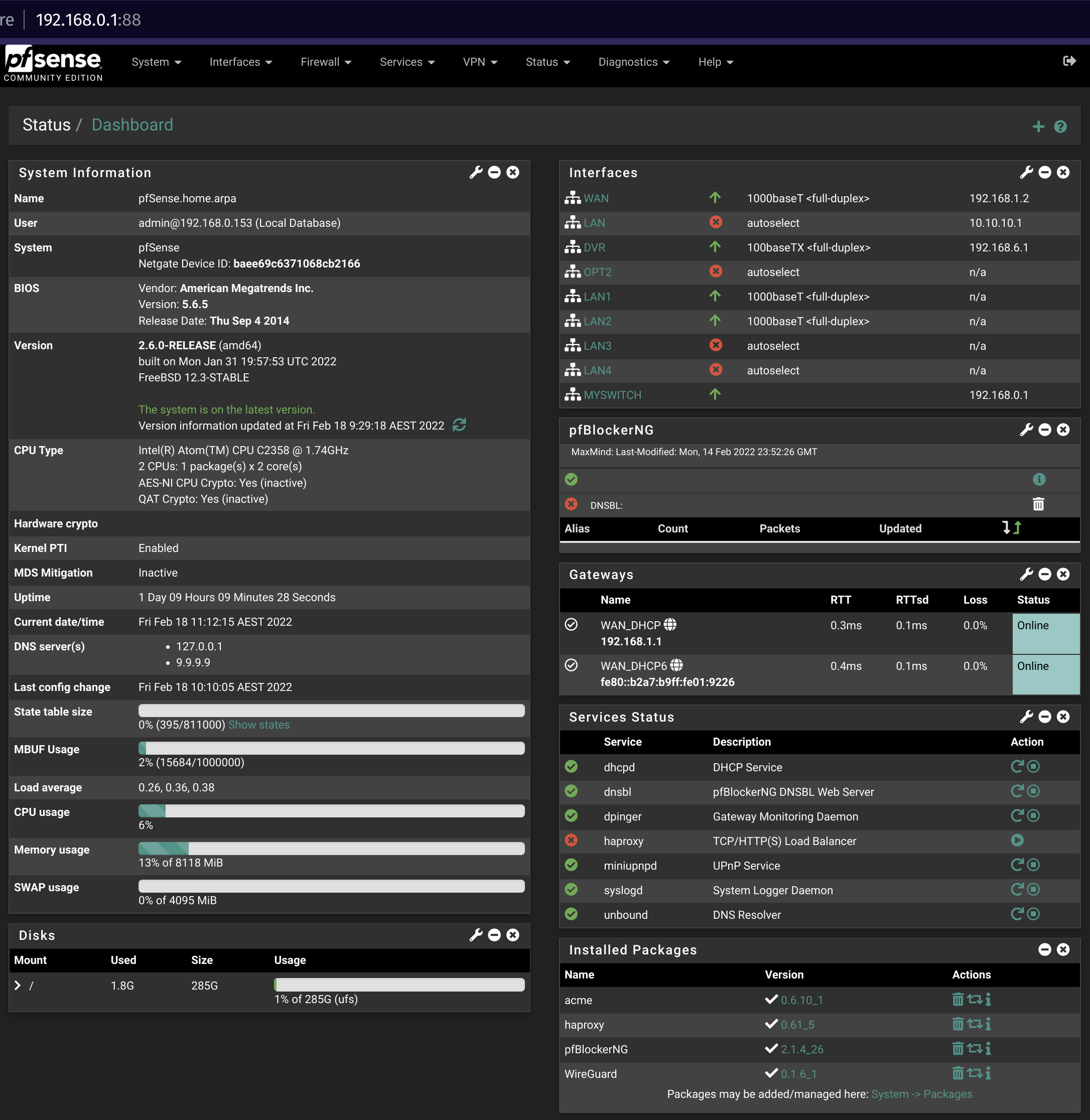

      SG125 Port Panel

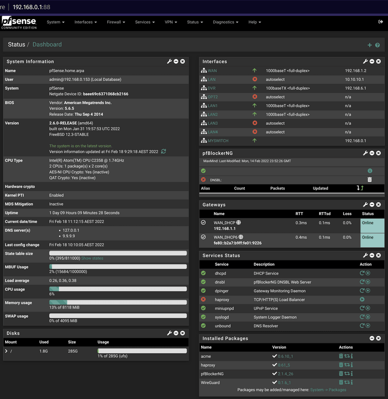

      ** pfSense Settings Screen**
      Interface screen

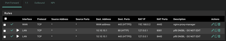

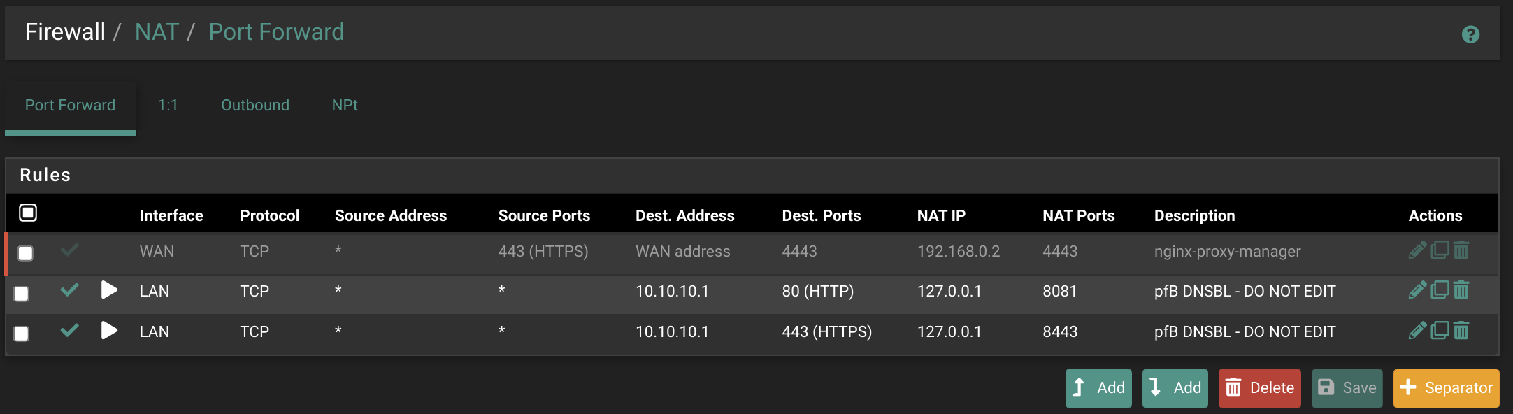

      Firewall port forward screen

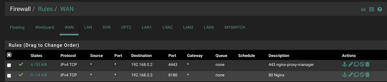

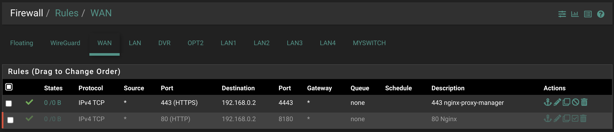

      Firewall WAN screen

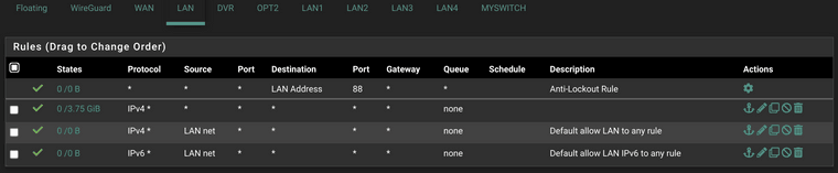

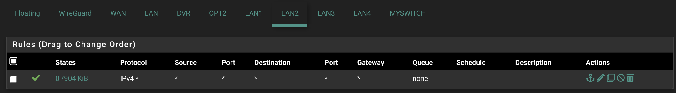

      Firewall LAN2 screen

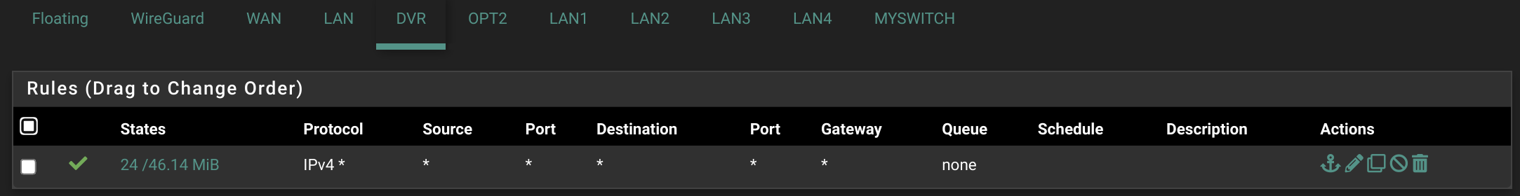

      Firewall DVR screen PROBLEM: I want to access this from LAN IP range but block it from accessing the LAN IP range incase it gets hacked.

        Your currently disabled port forward will not work because it has a source port set.
        The source port is usually some random high numbered port, it should be set to 'any' there.
        If you want to forward from standard https (443) to 4443, the destination port should be 443 and the NAT port 4443.
        You don't need any firewall rules on the DVR interface if you only need access to it. The only rules that have to be there are to allow it to connect out for DNS or NTP maybe.

          @stephenw10 Thanks for the reply and astute eye. Yes - I disabled as they weren't working but will try your suggestions now.

            Hello @stephenw10 - I made those changes but still no outside access..
            Do I need to remove these below?
            DVR: That makes perfect sense! Thank you!!!!

                So - I made a easy entry rule from the firewall error log. That showed me the issue straight away. Everything is perfect now!
                To wrap this up. I needed 1 port forward and 1 WAN rule.
                Thank-you!!!
                  Ah, good to hear.
                  Normally the firewall rule is auto-created when you create the port forward and linked to it so it changes if you change the forward. You can change that behaviour though which is looks like you did.
