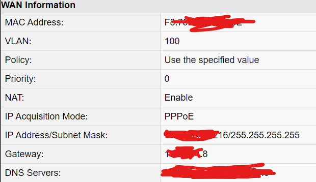

this is the output of the internet !

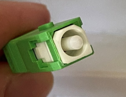

This the device that they installon

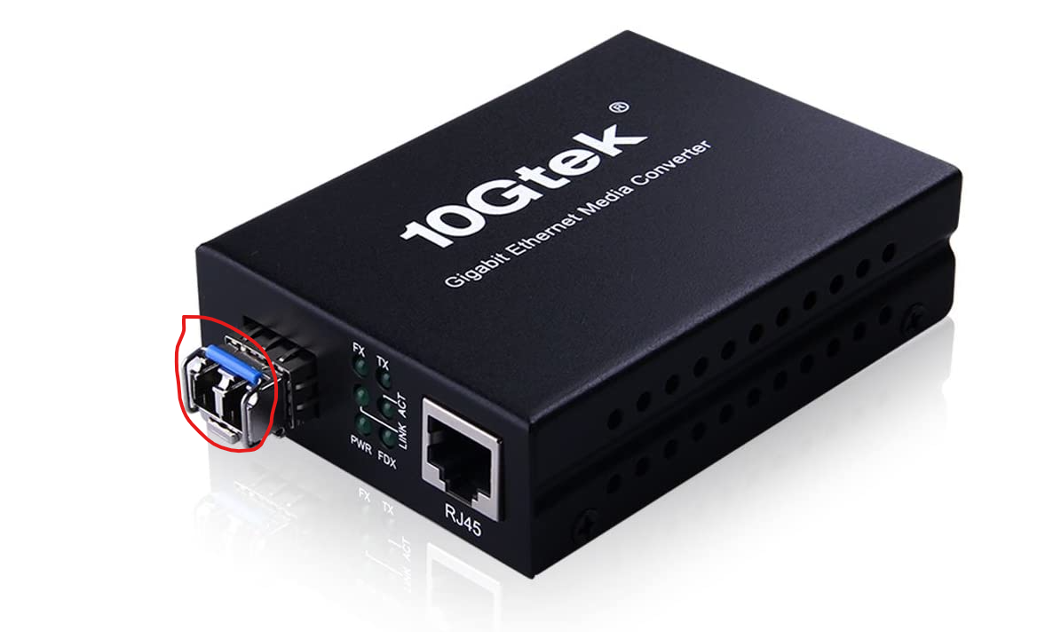

I FOUND THIS BUT MY DOUBT IS I SEE THAT HERE THE FIBER CABLE HAS 2 ENTRIES, MINE ONLY HAS 1
https://www.amazon.com/-/es/Convertidor-multimodo-transceptor-1000Base-Tx-1000Base-SX/dp/B06XBZB7P7?th=1

can you take a look at the amazon link ... please
I cannot say what will or won't work with that. The Amazon link is only a media converter with an SFP slot. You would still need to purchase a separate SFP module with a G.PON connector. You would have to contact the OEM of that media converter to find out if they have a list of compatible modules.
