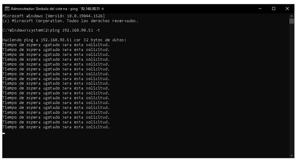

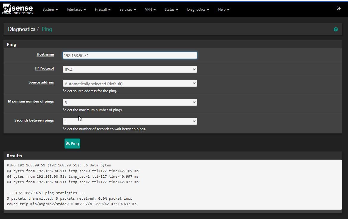

Hi all I have configured a site to site tunnel using wirguard, the details is that I can ping from the pfsesense 2.6 on node1 to a host on node2 but can not ping from the host on node1 to the pfsense on node2, I have the ip allowed in the tunnel configuration on node2, and I also have a static route where I indicate that the IPs must pass through the Gateway of the Wireguard interface.
When you ping from pfSense and leave the source set to auto it will use the closest logical IP. In this case that's probably the Wireguard tunnel address.
Try setting that as the source.
Then try setting the LAN as source.
It looks like you have either a missing route or firewall rule. Probably at the node2 end.
