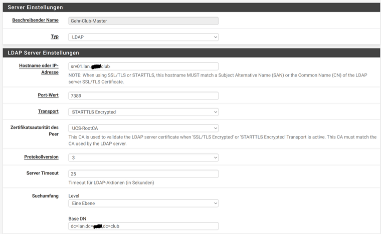

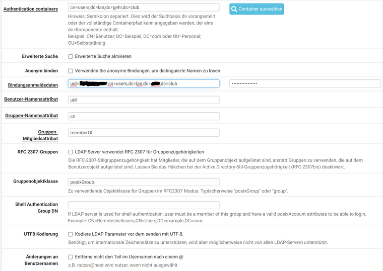

      I have connected the pfSense to the local LDAP server (UCS server).
      I have previously imported the UCS rootCA. This is also displayed correctly. Subsequently:
      • Authentication server +
      When I test a user with a password under Diagnostics -> Authentication, I get an OK.
      Under User Administration -> Settings -> Save & Test I get:
      Looks good to me. However, no LDAP users are shown in the pfSense in the user administration. What have I forgotten?
