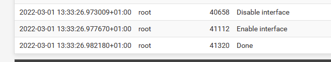

A command typed on the command line, can also be used in a script file **.When I created a text file called /root/test like :
#!/bin/sh /usr/bin/logger "Disable interface" /sbin/ifconfig em0 down /usr/bin/logger "Enable interface" /sbin/ifconfig em0 up /usr/bin/logger "Done"
And I make it executable
chmod +x /root/test
Now I can
/root/test
In the system log, I saw :
and it broke my connection for a moment, as my WAN interface is em0 for me, it went down and up.

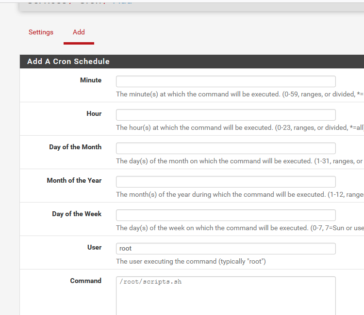

@deanfourie There is a cron package to manage cron jobs. As I recall if you manually add cron jobs, they are lost on reboot.
@steveits Yup, CRON package is installed.
Only thing I need to get right is to execute the script from the Cron job.
On the main cron page, you have 2 buttons :
How cron works, what you have to enter as the "time" needs some reading.
Any "FreeBSD cron man page" will do here. -
