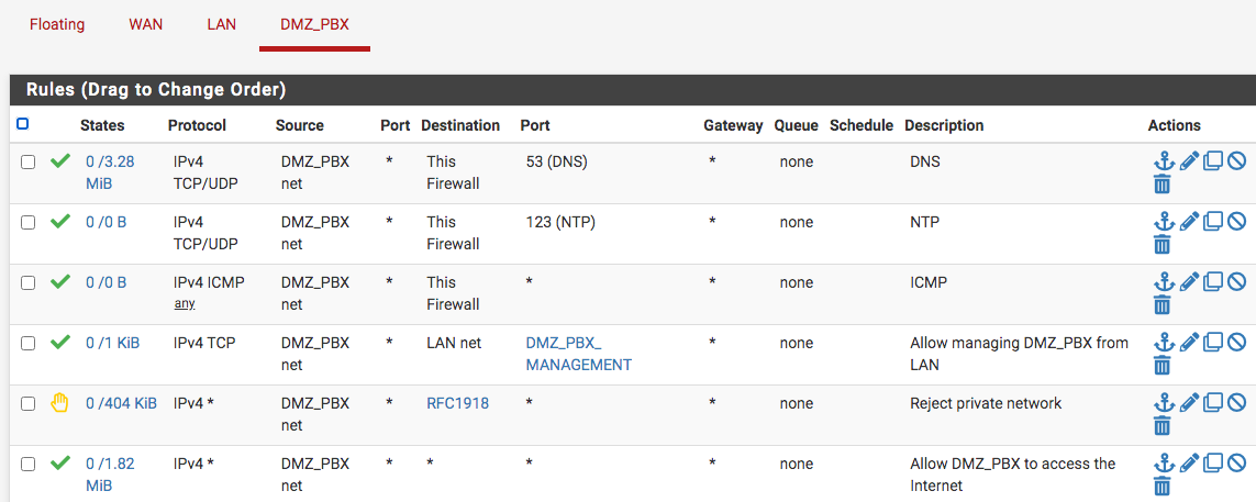

      But this is the firewall rules on the DMZ:

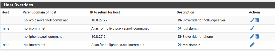

      The host override:

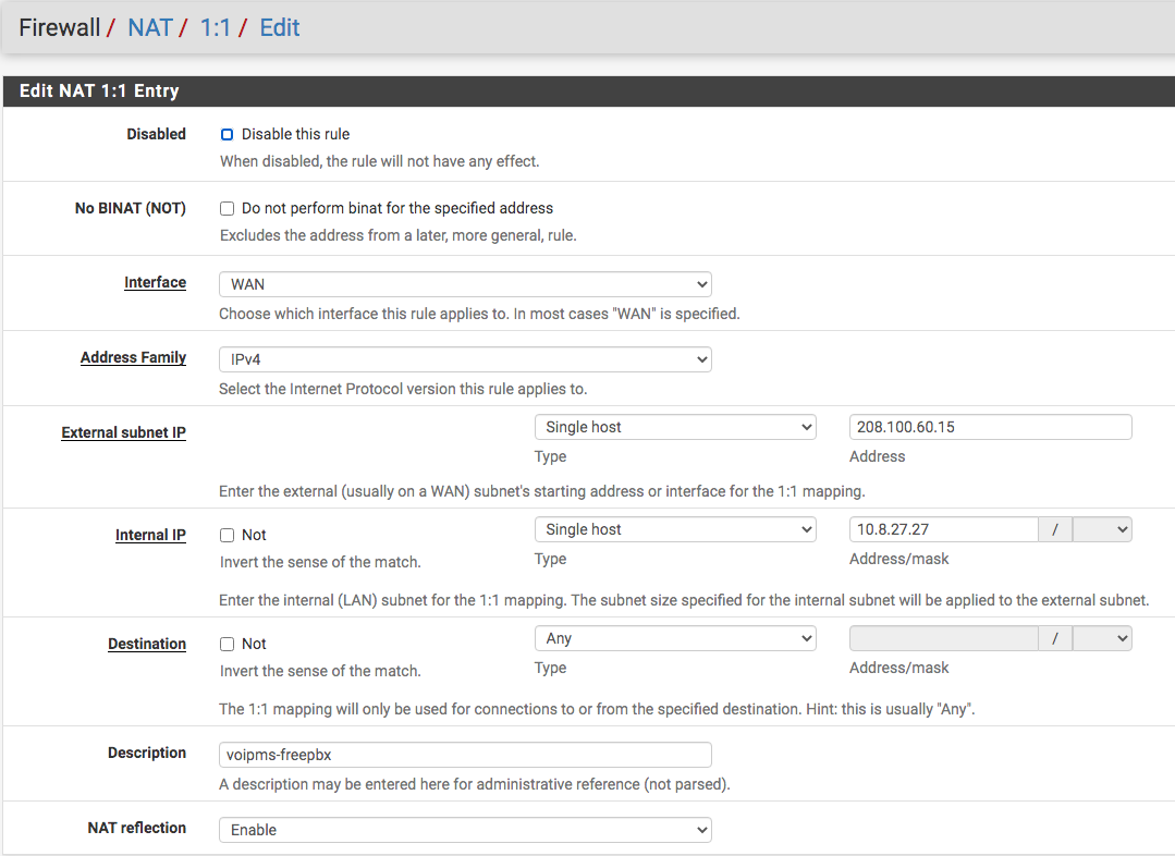

      1 to 1 NAT with NAT reflection enabled

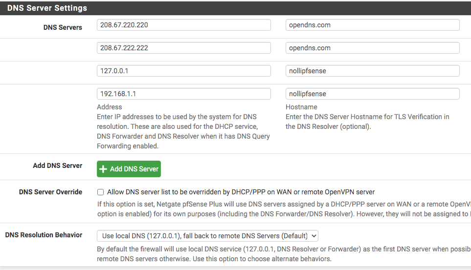

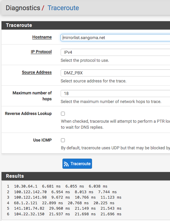

      And DNS:
      So, I am wondering whether somehow I boxed freepbx in unintentionally...if mirrorlist.sangoma.net was resolved to the IP (104.22.33.150), then it appears the split DNS is working...so the NAT reflection is the issue...but I disabled it and still wasn't going out. This has been puzzling me over the pass weekend to now why nothing going out the DMZ...I even disabled Freepbx firewall and still nothing going out to the Internet on the DMZ. I post here since this was the last configuration I had done on pfSense. Then, more confusion with this:
