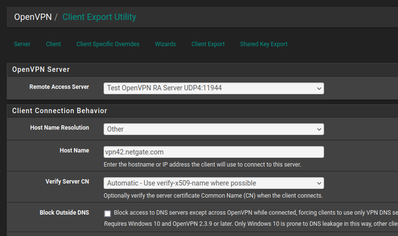

          @stephenw10 Thank you Steve, that's good to know. The only problem I have with this configuration is that I have to manually change the "remote" line of client configuration files automatically generated by the pfSense, since the WAN interface IP is the local one and not the public one. That is not a big deal at all though. Just good to know that I didn't configure it totally wrong :)
            You can change that in the exporter before creating the file. You save that as the default if you use that every time:
