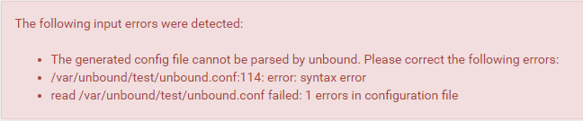

      Hi all,
      Running pfsense 2.6 and trying to enable DNS Query Forwarding within the DNS Resolver. When I try to save the settings, I get the following error but have no idea how to correct. Is this a known issuse? Any workarounds out there?
        What is on line 114 of that file?
        What in the Unbound 'Custom Options' field?
        Usually when you see issues loading Unbound it's because of custom values left from a pfBlocker install.
          mdecou @stephenw10
          @stephenw10 The only custom option I had was the following:
          private-domain: "plex.direct"
          If I remove that, I am able to turn on DNS Query Forwarding. I have yet to determine if my plex server will be affected.
          Thanks for your reply.
            johnpoz LAYER 8 Global Moderator @mdecou
            @mdecou you need server: above that..
            With the server: I would expect you would get a parse error.
            I just tried it without server, and do not seem to get an error - but not sure it would work.. But yeah you need that or your most likely going to run into a rebind error.
