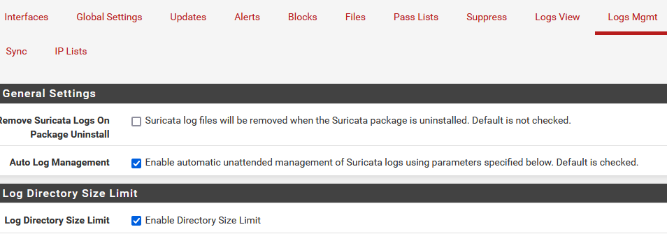

@shinobi Ensure you have the log rotation and deletion settings enabled for Suricata.
Also if your router has a slower CPU disable log compression in pfSense in the system log settings.

PHP ERROR: Type: 1, File: /usr/local/www/suricata/suricata_logs_browser.php, Line: 54, Message: Allowed memory size of 536870912 bytes exhausted (tried to allocate 6336420904 bytes) @ 2022-03-12 01:20:08Your log file has grown too large to view using the PHP viewer applet. That code works by loading the entire log into RAM and then displaying it to the browser as one string. The PHP process in pfSense has a limited amount of RAM allocated for it, so if the log file is too big, that limited RAM is exhausted when trying to load the log.
The solution, as @SteveITS said, is to turn on the log rotation options and set a much smaller log size for alerts.
