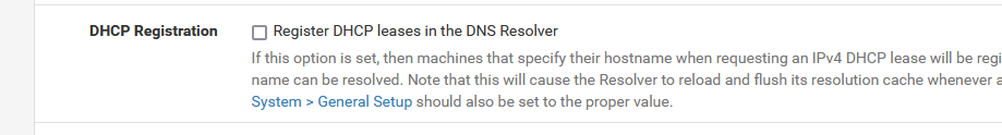

        In theory, this is a great option :
        In practice, look at the the Resolver log file : if you have many LAN clients devices using DHCP, this will kill your DNS : it restarts all the time. pfblocker has a negative influence on this restart time. during restart : no DNS.

        Positive ??
        During every new lease, and lease renewal, the DNS service will get interrupted as it has to restart.
        Again, check your DNS Resolver log (now for example) and see how many time you will find these words "info: start of service".
        I call that a negative effect.
        My advise :
        Do not check "DHCP registration" - but do check "Static DHCP" and add for all your devices a "DHCP static mappings in the DNS Resolver" .

            That's certainly not excessive for pfsense. And I think you might have misunderstood @Gertjan.
            Using the DHCP Registration option can significantly slowdown your DNS because every time a device connects to pfsense the DNS Resolver stops to rebuild the DNS table and then it restarts. This is even more impactful when you are using pfblocker because during that rebuild process it has to load all of the pfblocker domain lists into DNS Resolver.
            As I mentioned yesterday in your other post. If you are using pfblocker do not use the DHCP Registration. If you do have particular DHCP clients that you want registered in the DNS then assign them a Static Mapping and use the "Static DHCP" option in DNS Resolver.
