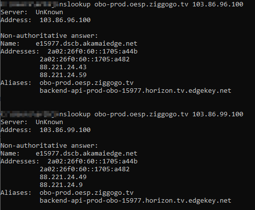

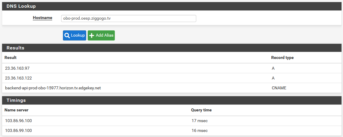

I am using pfsense 2.6 and have a DNS related issue.I am using 2 DNS servers from NordVPN. When using the DNS lookup of psfense (or using nslookup via console), it is returning other IP addresses for obo-prod.oesp.ziggogo.tv then when I am executing nslookup (with same DNS servers) on my windows 10 laptop.

I understand when executing an nslookup with different dns servers, the returned addresses can be different. Or when executing an nslookup using same dns server via a VPN and via non VPN connection, the returned addresses can be different. That is not the case here.I am executing an nslookup on a windows laptop on my local network that is accessing internet via the pfsense router. When executing a DNS lookup on that same pfsense router it is returning different addresses. So I do not see, that different IP's are returned for different CDNs. Right?
Even when I am executing an nslookup on a windows laptop on my local network that has the pfsense router as DNS server, it is returning different addresses (same as in the cmd screenshot) then when executing a DNS lookup on that same pfsense router.

@meridium OK I think that explains it. If you are using Resolver then your LAN clients will get the authoritative response. However, pfSense for its own needs uses the DNS you have listed in General Setup. If you want to make it consistent, remove the NordVPN entries and add 127.0.0.1 to the DNS server list.
@kom My laptop is using pfsense as my local DNS server. So my laptop gets the (cached) authoritative response from pfsense. And pfsense gets the authoritative response from one of the DNS servers under General setup, right? If I remove the DNS servers of pfsense and replace it by 127.0.0.1, how will pfsense ever query any DNS server on the internet?
But you triggered me by hinting to remove the current DNS server addresses and adding 127.0.0.1 to it. Under System - General setup 'DNS Resolution Behavior' was not set to the default value. Was set to 'Use remote DNS Servers, ignore local DNS'. Not sure why I have done this. I have changed it to the default value 'Use local DNS (127.0.0.1), fall back to remote DNS Servers (Default)'. Now it seems to return correct IP addresses for obo-prod.oesp.ziggogo.tv.
