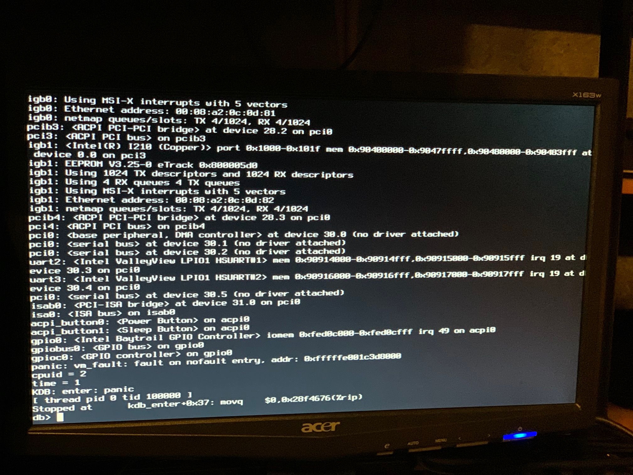

Here’s where things panic:

Hmm, have you updated the BIOS on that 4220? There are two device types we have seen that differ by BIOS version. The installer uses these to recognise the board but perhaps yours is reporting something else.
The panic you saw above is not what I expect to see after trying to install and boot ZFS.
By far the easiest way to do this, if you want to run ZFS, is to choose the 'make changes' oprion at the end of the installer and edit the loader file then.
