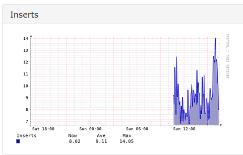

      My insert graph looks like this

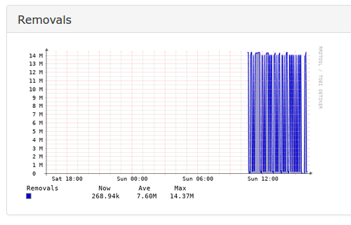

      and my removals graph looks like this
      Why would the removals be in the millions ?
      Any ideas where to start looking ?

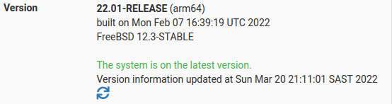

        Hmm, that seems.... unlikely!
        What pfSense version is that?
          dandare100 @stephenw10

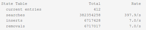

              I can see these on the firewall itself

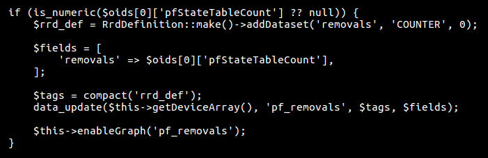

                  Found it.
                  It looks like a copy and paste error in the LibreNMS pfsense "OS module"
                  I will let them know.
                  Thanks again
