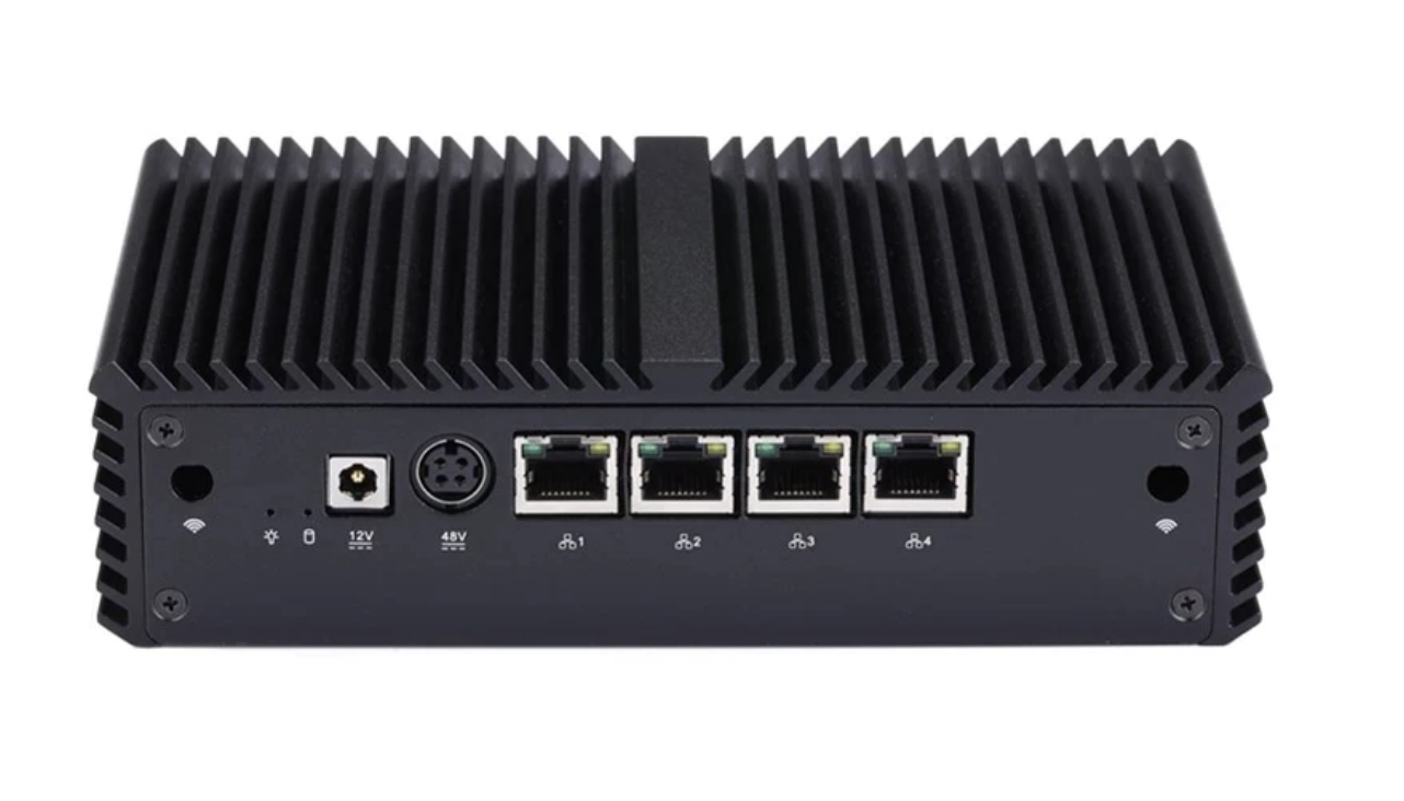

                            • JKnottJ Offline
                              JKnott @lmendoza
                              @lmendoza
                              You might consider a Qotom mini PC. I bought one last year (see sig) and they come in a variety of configurations. They seemed to have pfsense in mind when the designed them.
                              UniFi AC-Lite access point
                              • N Offline
                                nimrod @JKnott
                                @jknott said in Difference of whitebox vs SG-6100:
                                @lmendoza
                                My friend got Qotom mini PC, and i immediately discovered several very annoying issues with it. If there is a power outage, device doesnt power back on when power comes back. You have to manually press the power on switch to power it on. And unlike every other device out there, Qotom decided that this "feature" should be controlled with the jumper setting instead of BIOS setting. To make this even more confusing for inexperienced users, this option is actually available in BIOS, however, it gets completely ignored and it does nothing. After setting the jumper in correct position, device powers on automatically as soon as power is applied.
                                Majority of Qotom customers are buying these devices to use them as firewall appliances and routers. Why they decided that this should be default setting on all of their devices is beyond me. Also. Not everyone wants to open brand new box and fiddle with jumpers. There is no manual for this. I had to google it. Its a known problem with Qotom devices.
                                Another issue is built in PC speaker that works without issue when you power on device. I can clearly hear BIOS beep. However, once pfSense boots up there is no classic beeping sound that indicates that pfSense is finished loading. Also, there is no beeping sound when you initiate reboot from pfSense. Why? Because all beeping sound gets redirected from internal PC speaker to integrated sound card. Yes. Beeping sound is actually there but you can hear it only when you plug in your headphones into 9mm jack.
                                There is another issue that may scare some people. If you press power button while pfSense is up and running, device will shut down and you wont be able to power it back on. Device doesnt power on even if you pull the power cord out and put it back in. You actually have to pull it out, press and hold the power on button, and while holding it, put the power cord back in. And then device will power on.
                                Also, there is no CoreBoot BIOS available for any Qotom devices.
                                All above issues aside, once you install pfSense, it all works. Device is cool and silent. It runs stable without any additional issues.
                                bingo600B JKnottJ 2 Replies Last reply Reply Quote 0
                                • bingo600B Offline
                                  bingo600 @nimrod
                                  @nimrod
                                  I have about 15 x i5/i3 Qotoms home + work
                                  All of them adhere to the Bios setting of : "State when power is lost"
                                  What model is your "problem child" ?
                                  Was this the "jumper doc" ?
                                  https://www.youtube.com/watch?v=-2pZi3hf2f4
                                  If you find my answer useful - Please give the post a 👍 - "thumbs up"
                                  pfSense+ 23.05.1 (ZFS)
                                  QOTOM-Q355G4 Quad Lan.
                                  CPU  : Core i5 5250U, Ram : 8GB Kingston DDR3LV 1600
                                  LAN  : 4 x Intel 211, Disk  : 240G SAMSUNG MZ7L3240HCHQ SSD

                                    • JKnottJ Offline
                                      JKnott @nimrod
                                      @nimrod
                                      Of those issues, the only one I have is the speaker. But I don't have much of a need for it. The power on setting is in the CMOS of mine.
