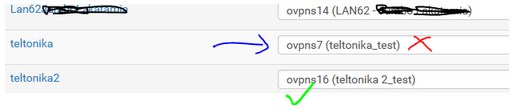

There is a problem with OpenVPN server interface (ovpns7).
The initial configuration was remote access ovpn server, one day the service couldn't start, even if i set watchdog to restart it.After many other successful vpn servers configuration, this ovpns7 still not working, even if i remove everything related and reconfigure again for site to site tunnel, has taken ovpns7 interface because was empty. The only workaround i found, is to let this broken interface ovpns7 just there and continue to next one so the interfaces get another number. very strange to me , first time i saw something like that.
ovpns15 is a remote access vpn so i didn't enable as interface.
ovpns 16 is working.
Stay on pending forever ! no IP, no status.
Service not starting.

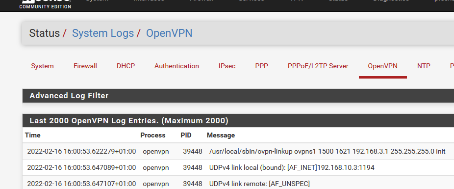

@gertjan there is no logs in open VPN tab (Status-> system logs, OpenVPN) , just in the system. Since VPN service not starting, seems reasonable.
