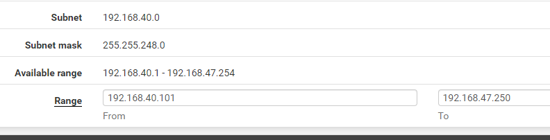

      pfSense 22.01 is the firewall/router used at our high school. There is an SSID that corresponds to the VLAN for the students' address space: VLAN 40 192.168.40.0, subnet mask 255.255.248.0 with an available range of 192.168.40.1 to 192.168.47.254. pfSense is the sole provider of DHCP addresses. All other DHCP settings are at default values (blank).

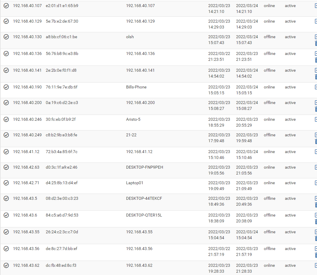

      Over the past several weeks, a "hole" has formed in the middle of the DHCP address range, and only one IP has been assigned from the 192.168.41.0 network, and only 2 IP addresses from the 192.168.42.0 network have been assigned. See the screen print of the Status / DHCP Leases screen.
      Any suggestions regarding about what steps I should take regarding this issue? ... or should I just let it climb to 192.168.47.254 and allow it to "roll over"?

        Yeah why would it matter? Other than some sort of OCD issues - the IPs out of the pool could be assigned completely random. But yeah dhcpd tends to count in a specific order either from the start of the pool and up, or from the top of the pool down, etc.
        Why it would of skipped is a bit odd, but you would have to look in your lease file - there could of been some reason it like a old or corrupted lease or something.. Or maybe a client requested specific IP, and that jumped it where it was counting from?
        It is a bit odd, but doesn't really matter in the big picture.

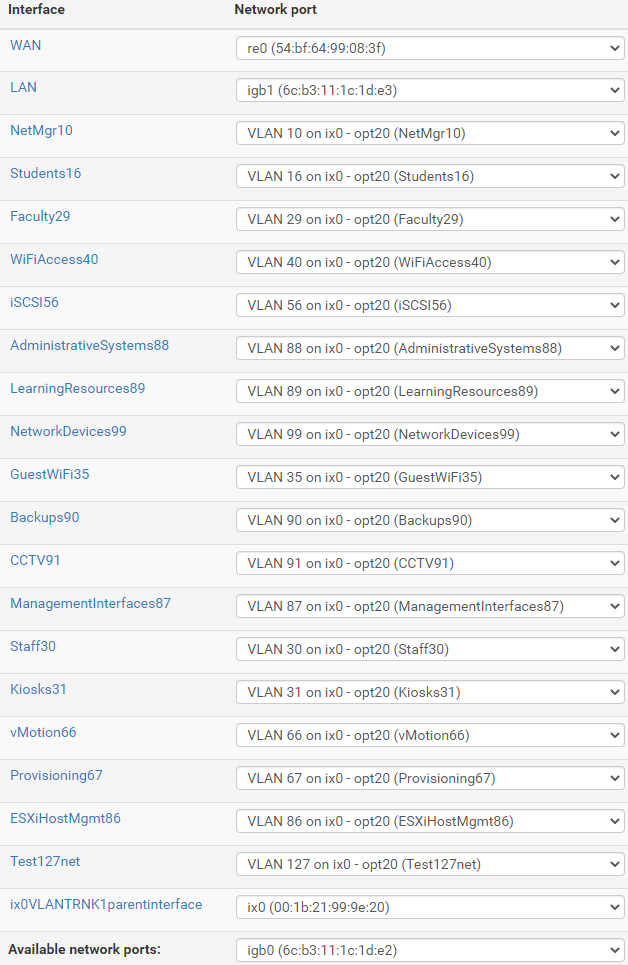

                  Following your advice, I looked into the DHCP leases files. There are two "db/dhclient.leases" text files:
                  /var/db/dhclient.leases.re0 <-- current WAN interface name
                  /var/db/dhclient.leases.igb0 <-- old VLAN parent interface name
                  I had changed the VLAN parent interface from a 1Gb/s NIC (igb0) to a 10Gb/s NIC (ix0), so the /var/db/dhclient.leases.igb0 file is pointing to an unused interface.
                  The re0 WAN file has the DHCP options from the ISP, like DNS servers, time servers, etc.
                  The /var/dhcpd/var/db/dhcpd.leases file is the server's lease options to it's clients.
                  It has 427 IP addresses, but only 333 are unique, so there are duplicates in the file.
                  John, is there something I should try? I can set up a test pfSense instance based on the XML backup of the working instance, and keep it off the production network and run some testing?
