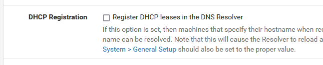

      By design enabling client to register their hostname restarts Unbound.
      Is there any solution to prevent this restart?

                @iorx said in Get around DNS restart and still have client register?:
                The DHCP servers still works just fine.
                The /var/dhcpd/var/db/dhcpd.leases file still contains the actual state of all leases on the LAN"s.
                Unbound doesn't use or read "/var/dhcpd/var/db/dhcpd.leases"
                The process dhcpleases was created to read from the file /var/dhcpd/var/db/dhcpd.leases and outputs in the classic /etc/hosts file and /var/unbound/dhcpleases_entries.conf file. This on is sourced by the unbound config file.
                The thing is : unbound only reads its config during startup.
                It can not (re)read this file, or any other file when it's doing what unbiound does : resolving.
                if it did, resolving would get limited to disk IO speed. Resolving will take a huge hit in speed.
                51741  -  Ss       0:00.01 /usr/local/sbin/dhcpleases -l /var/dhcpd/var/db/dhcpd.leases -d my-local-domain.tld -p /var/run/unbound.pid -u /var/unbound/dhcpleases_entries.conf -h /etc/hosts
                What it does : if wait for a file event on "-l /var/dhcpd/var/db/dhcpd.leases". If that event happens, it get parsed, and "-u /var/unbound/dhcpleases_entries.conf" ( and -h /etc/hosts) are re created.
                Then, if "-p /var/run/unbound.pid" exists, then unbound is actually running, so dhcpleases send a signal to it.
                This is the message :
                Drop dead, and resurrect.
                This is how new leases get registered ion the DNS.
                Actually quit elegant, even I could have written it.
                Its actually not bad at all as an implementation.
                Now, with our modern day networks filled up with all the Chinese ** connected gadgets that execute a DHCP every x seconds or so and/or behave as of their lease is 1 second, no matter what.
                You've just nuked your unbound (DNS) process.
                A problem like this couldn't exist in the past. When a new device was added, (dhcp) log files were closely observed, to be sure nothing out of the ordinary shows up.
                Local bandwith wasn't an close to unlimited resource back then. We didn't have Multi tera flops processors to handle nice stuff like web servers for GUI's.
                ** you know what I mean. admin's these day can also use bad cables, lousy switches, or use bad power, or messed up wifi signals. All these are good ingredients in the "let's chain gun pfSense with DHCP requests".
                keyserK iorxI T 3 Replies Last reply Reply Quote 1
                                        @keyser
                                        https://redmine.pfsense.org/issues/5413
                                        But I read this thread correctly? To me it looks like a solution has been delivered there, tested and committed?
                                        Yeah, I thought that as well until i read the thread carefully - including inspecting the dates on posts.
                                        The proposed code based on the high level code has never been adopted beyond a proposal. The proposed fix thread then stopped once that happened (more than a years ago).
                                        The reason we misread the thread is because someone suggests you just disable DHCP registrations, and another poster confirms that fix works well. But he’s not talking about the code, he’s talking about the workaround to disable DHCP registrations.
                                        So it’s still a dead end…..
