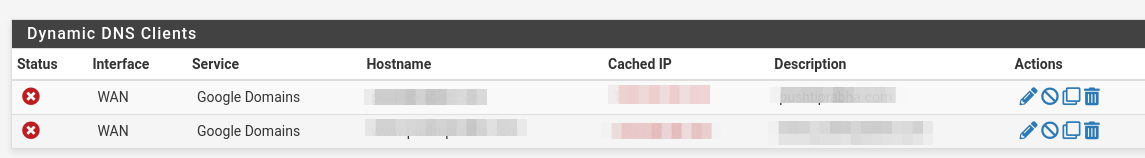

      Hi it seems like Dynamic DNS is broken after I upgraded to pfsense+. I am on latest 22.01-RELEASE.
      I see the red is status and my IP is sticking to an old IP. Has any one have this issues?

          I see the following error in logs as I enabled the verbose logging:
          "Public IP address could not be extracted from Check IP Service"
            johnpoz LAYER 8 Global Moderator @andy22
            @andy22 said in Dynamic DNS broken after pfsense+ upgrade:
            That would suggest that you can not reach the service your using to determine the public IP.
            By default it would be http://checkip.dyndns.org
            Can you open that in a browser? Do you get your public IP?
              andy22 @johnpoz
              @johnpoz
              I can reach that site http://checkip.dyndns.org and get IP address correctly.
              Also I can do curl from my pfsense box and get the results back.
                SteveITS Rebel Alliance @andy22
                @andy22 If you install the System Patches package you'll see the recommended patch:
                Fix Google Domains Dynamic DNS response processing (Redmine #12754)
