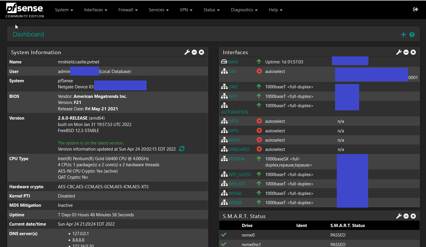

      Is there a way to resize the dashboard?
      I want to start adding IPv6 support on my firewall interfaces but now that I put it on two interfaces the dashboard no longer looks nice.
      Is there a way to change the widget width and in a way that won't break with updates?

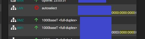

            Just so you know this is what it looks like with IPv6 addresses (which end up truncated anyway):
            The most noticeable problems are the truncated IPv6 addresses and the interface names positions.

            PS: I know there is a lot of red here... It's a combination of defective hardware (which is supposed to arrive today) and currently unused interfaces.

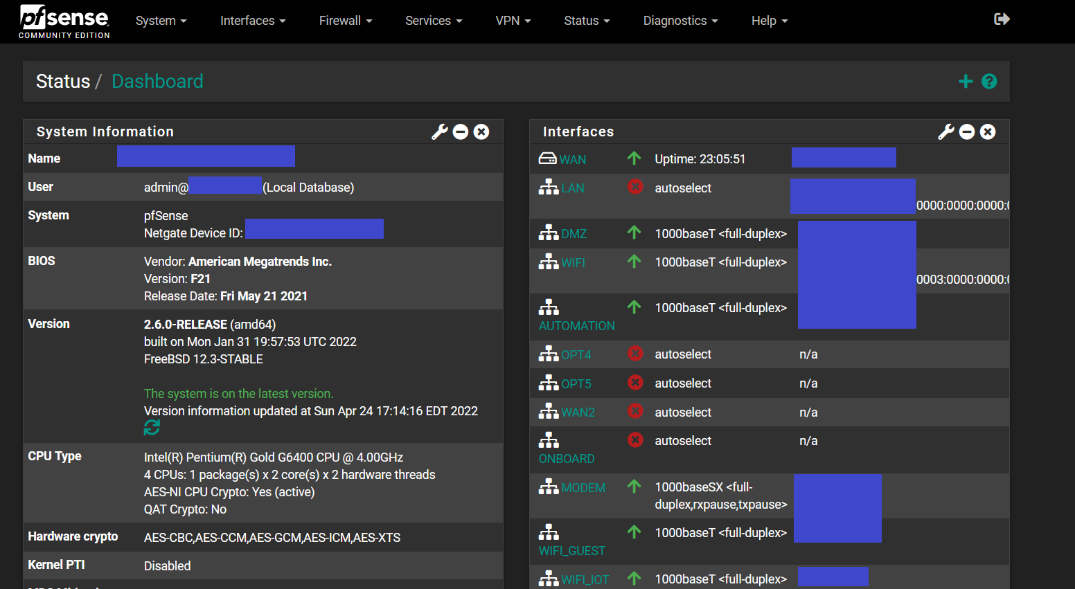

                That being said, I found a partial workaround...
                The -BETA themes seem to use a smaller font so a full IPv6 address can be shown...
                The interface names still end up on the second line sometimes and everything is in a smaller font not solely the IP address so it is not a perfect solution but quite usable in the mean time...

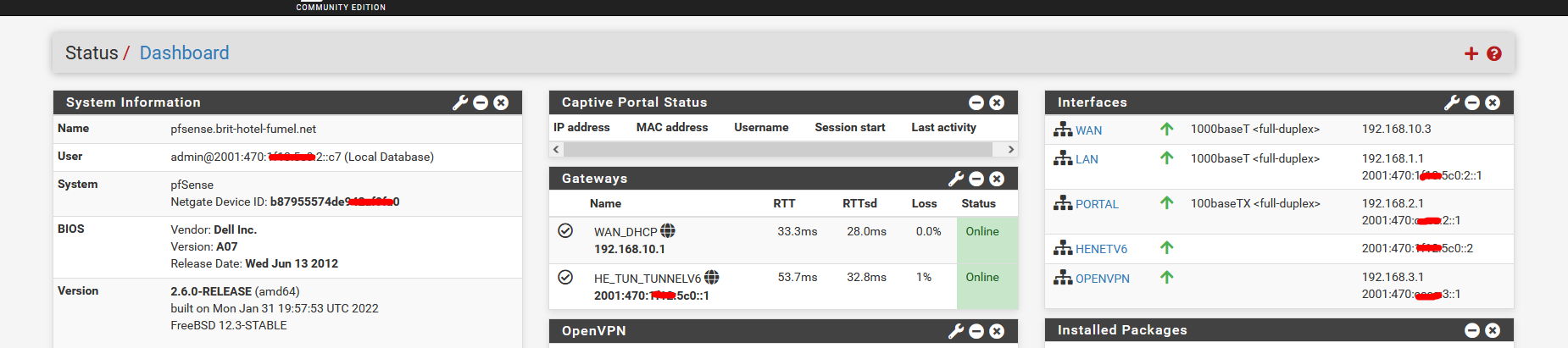

                  @knight said in Is there a way to resize dashboard?:
                  The GUI expands IPv6 ? I don't see that happing :

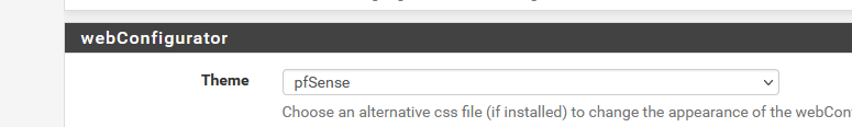

                  Compare this list :
                  with what you find in this folder : /usr/local/www/css/ and you' re half way ;)
                  Don't edit files, add your own. It's lost during upgrade ? No issue, just put it back in.

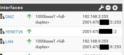

                    @gertjan said in Is there a way to resize dashboard?:
                    I think your v6 IPs happen to have a lot of 0s so they end up taking less space. They are truncated in my installs.

                        @stephenw10 said in Is there a way to resize dashboard?:
                        But his do as well, not sure why these are expanded out..
                        Those should just be ::, also in his other post 0001 is expanded out??
                        That seems odd as well.. See in first post where its 0003, that shouldn't be like that either.. See mine where I have a 3 in my address, but its just shown as 3, not 0003, and see were address ends in a single digit 2, its not 0002
                        edit: Ah if he wrote them like that?? Maybe that is why their fully expanded.
                        edit2: You could also just get a wider screen or run higher res, I have 4 columns in my dashboard and pretty happy with the layout and overlap of stuff.. There is some minor stuff - but all readable.. If I set it 3 columns there is none.. But then again I don't fully expand my IPv6 ;)
                        NogBadTheBadN K 2 Replies Last reply Reply Quote 0
                        • stephenw10S Online
                          Mmm, I was thinking there may have been some other collapsed section under the redaction but, I agree, that doesn't explain :0003: vs :3:

                            @johnpoz said in Is there a way to resize dashboard?:
                            I just added leading zeros to one of the interfaces and the interface now shows as:-
                            So the widget isn't stripping them, however an ifconfig on the interface doesn't show the leading zeros.
                            Andy

                              I typed them like that...
                              I do know that you can strip "0" from them but I have never played with IPv6 before so I preferred not to use the shorthand notation until I was more comfortable with the thing...
                              I did not realize until someone else posted a few posts ago that the screen assumed the IPv6 addresses were written using the shorthand notation and that my choice of writing them in their entirety was to blame...
