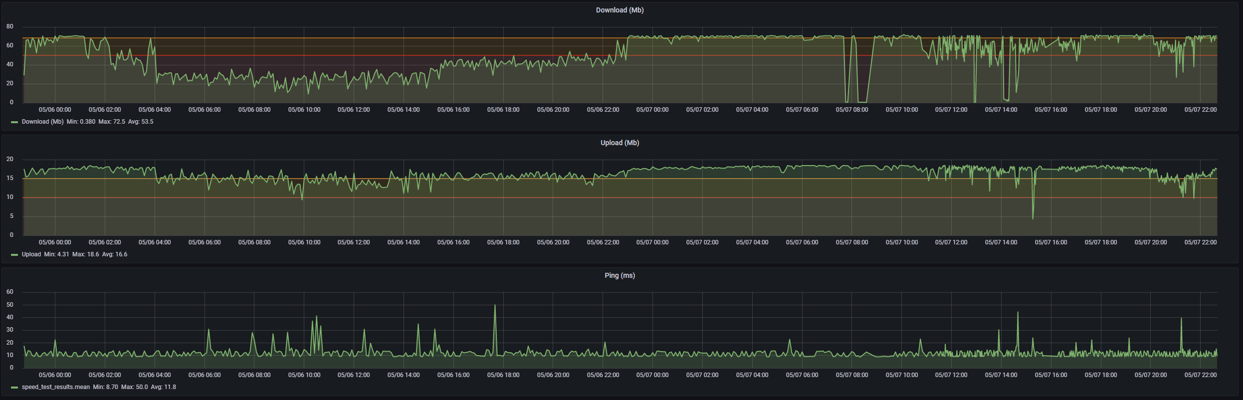

      Been having some issues lately with network stability.
      Im in the UK running a Vigor 130 Modem on a BT Business connection.
      My old pfSense box started dropping connection for long periods of time requiring a restart to remedy the issue, I could not access the webgui during these drop outs. I thought it could have been a symptom of a hardware failure, maybe a dead memory stick or NIC so swapped out all of my H/W for fresh stuff which I had from a previous build which I knew worked. Did a fresh install of pfSense 2.6 and then imported my old config. The issue still persisted so I checked the modem, I swapped the Vigor out for a spare BT Openreach modem I have, still the same issue. At this point I was seeing a reduced sync speed on the Vigor as well, and the drop outs were becoming more regular but shorter, when the WAN connection was on it was provided unreliable speeds too, ranging from 1mbps to 55mbps. One thing I also noticed was that after most drop outs I could no longer access the webgui until I restarted php-fpm using either SSH or directly on the router.
      We had an engineer come out from BT as I thought it was an issue with the line between the house and the cabinet, this turned out to be partially true, as there was an issue with some of the DSL ports scattered around the house, as a result he disconnected all but 1 of the additional DSL ports in the house. This initially seemed to remedy the issue for around 4 days we had a solid connection with no dropouts testing consistently at 70+mbps.
      Then today comes around and the issue has returned, regular drop outs with sketchy speeds. The sync speed on the Vigor is still reading correctly this time though. This is leading me to believe that part of the issue may be config related but I am unsure what as I havent changed anything major recently.
      Below are the logs immediately after the pfSense box has recovered from a drop out.

          To give an ideal of how wildly different things can get here is an image from my grafana speedtest DB from the last 2 days.
          Spencer
          • stephenw10S Online
            Mmm, that doesn't look too bad. Some spikes like that when the line is saturated are to be expected.
            But if you saw loss hit the 20% default threshold then the gateway would be marked down and the gateway action scripts fired. If you only have one gateway that only cause unnecessary disruption since there's no failover gateway.
