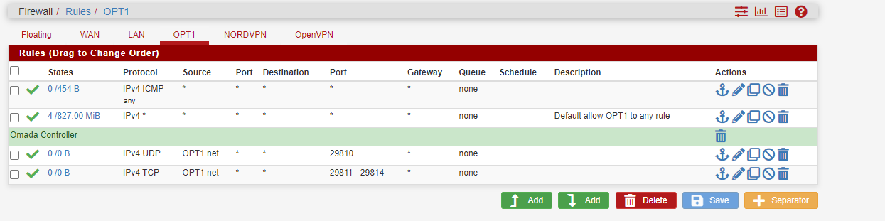

        @ace-1 Show the rules.
          ACE 1
            ACE 1
            • Bob.DigB Offline
              Bob.Dig LAYER 8 @ACE 1
              @ace-1 Create an RFC1918 Alias for you LAN, it can't work if the nord-gateway (or any other gateway) is first for destination any.
              Or just make a rule LAN to OPT without a gateway on top of LAN.
                ACE 1
                Like this?
                  ACE 1
                  That works for my IoT devices now but I loose my VPN for 10.10.0.9.
                  Created the second rule you said and it worked, VPN up on 10.10.0.9 plus I can get the IoT device webpage.

                      @ace-1 said in NordVPN and Pfsense with LAN and OPT1 Routing, can't access IoT device with VPN enabled:
                      Your a genius !!!!!!!!!!!!!!!!!!!!!!!!!!!!!!!!!!!!!
                      Or you have to learn some more of the basics. ๐Ÿ˜‰
                        ACE 1
                        Your probably right about that, I still can't get my head around the firewall rules. I am looking in the logs to see what is happening but it seems the basic stuff controls everything.......well I will continue to keep reading.
                        Thanks again for the help
                        • Bob.DigB Offline
                          @ace-1 It is easy. ๐Ÿ˜‰
                          For instance, your rule there has a destination of any (everything) and it has a gateway set, which means, everything has to go through that gateway out to the internet, so no chance for you to connect to IoT anymore.
