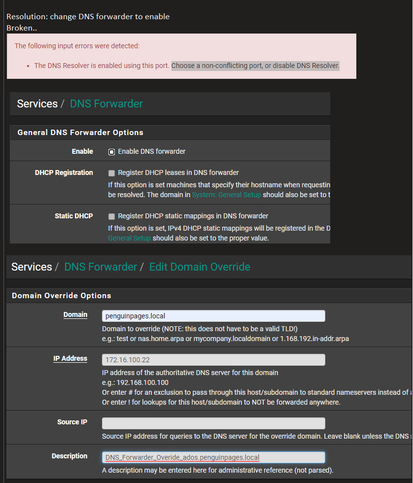

      Not sure.. but poked around and thought maybe it was DNS Forwarder presedence
      Resolution: change DNS forwarder to enable
      Broken..
      But.. nope.
      If someone has some has example or RTFM to where I can read up and correct DNS search paths for internal router, and VPN connected users

        The resolver (Unbound) runs by default rather than the forwarder (DNSmasq) but it can run in forwarding mode.
        However that shouldn't be required here. You should be able to enter the host or domain override to the resolver.

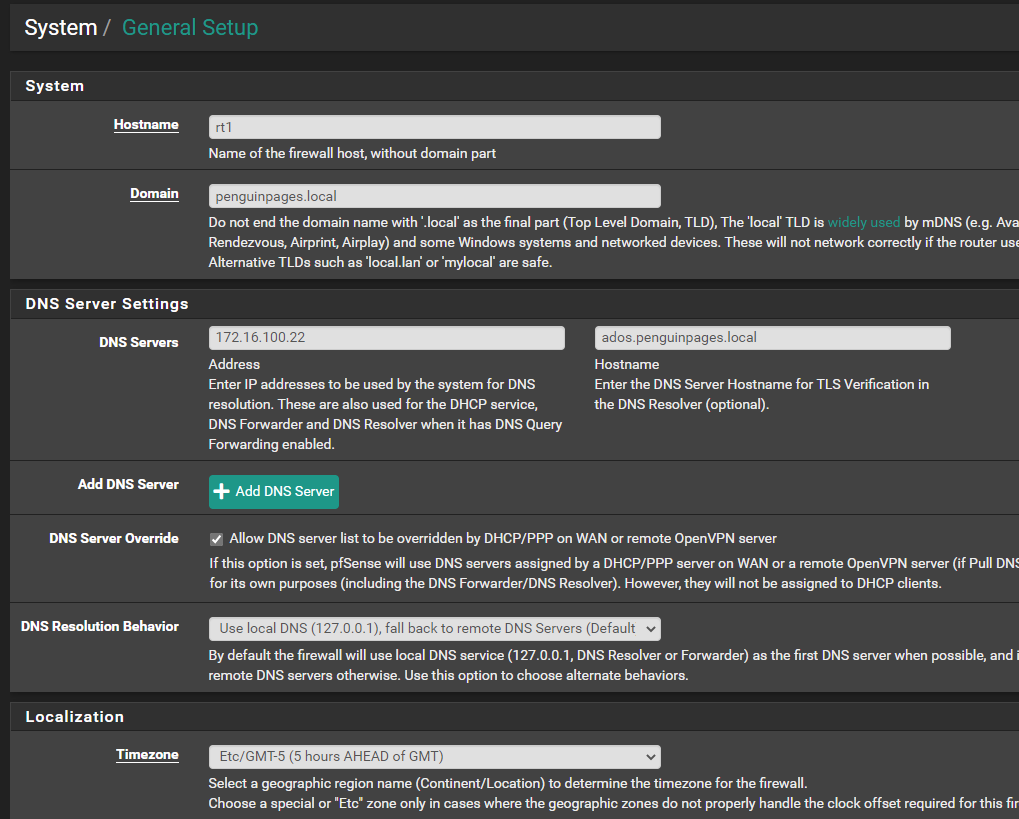

        If you test in Diag > DNS Lookup you can see all the DNS servers configured and what they are returning.
        The actual order is determined in System > General setup in 'DNS Resolution Behavior'.
        https://docs.netgate.com/pfsense/en/latest/config/general.html#dns-resolution-behavior

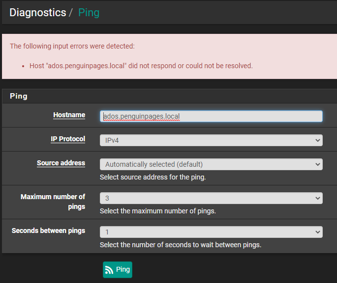

          I kind of figured as much. Unbound I thought would do parallel search within context of services listed. Ex: Search penguinpages.local (intranet) it would find just in that the DNS SOA for that zone is within the environment and in list.
          Host "ados.penguinpages.local" could not be resolved.

          [2.6.0-RELEASE][admin@rt1.penguinpages.local]/root: ping ados.penguinpages.local
          ping: cannot resolve ados.penguinpages.local: Unknown host

          • johnpozJ Online
            johnpoz LAYER 8 Global Moderator @penguinpages
            @penguinpages said in DNS Search Binding Order - Intranet then Internet:
            Set local DNS server + 8.8.8.8 (google)-> Assume it would
            Doesn't work that way..
            When you set more than 1 dns on a client, you really have no idea which it might ask. If it asks google for something.local it would get back a NX, and wouldn't ask any other ns it has listed.
            btw .local is a horrible choice for a local domain tld.. .local is special use.. don't use it or your going to run into issues.
            use home.arpa as you local domain name or whatever.home.arpa etc..
            so you would have host.whatever.home.arpa as a fqdn for your local resources or just host.home.arpa, etc.
              Mmm, either uncheck 'DNS Server Override' and set 'DNS Resolution Behavior' to Use remote.
              Or set a domain override for penguinpages.local in Unbound to use the AD server.
