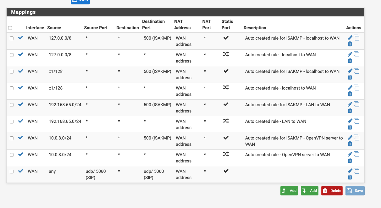

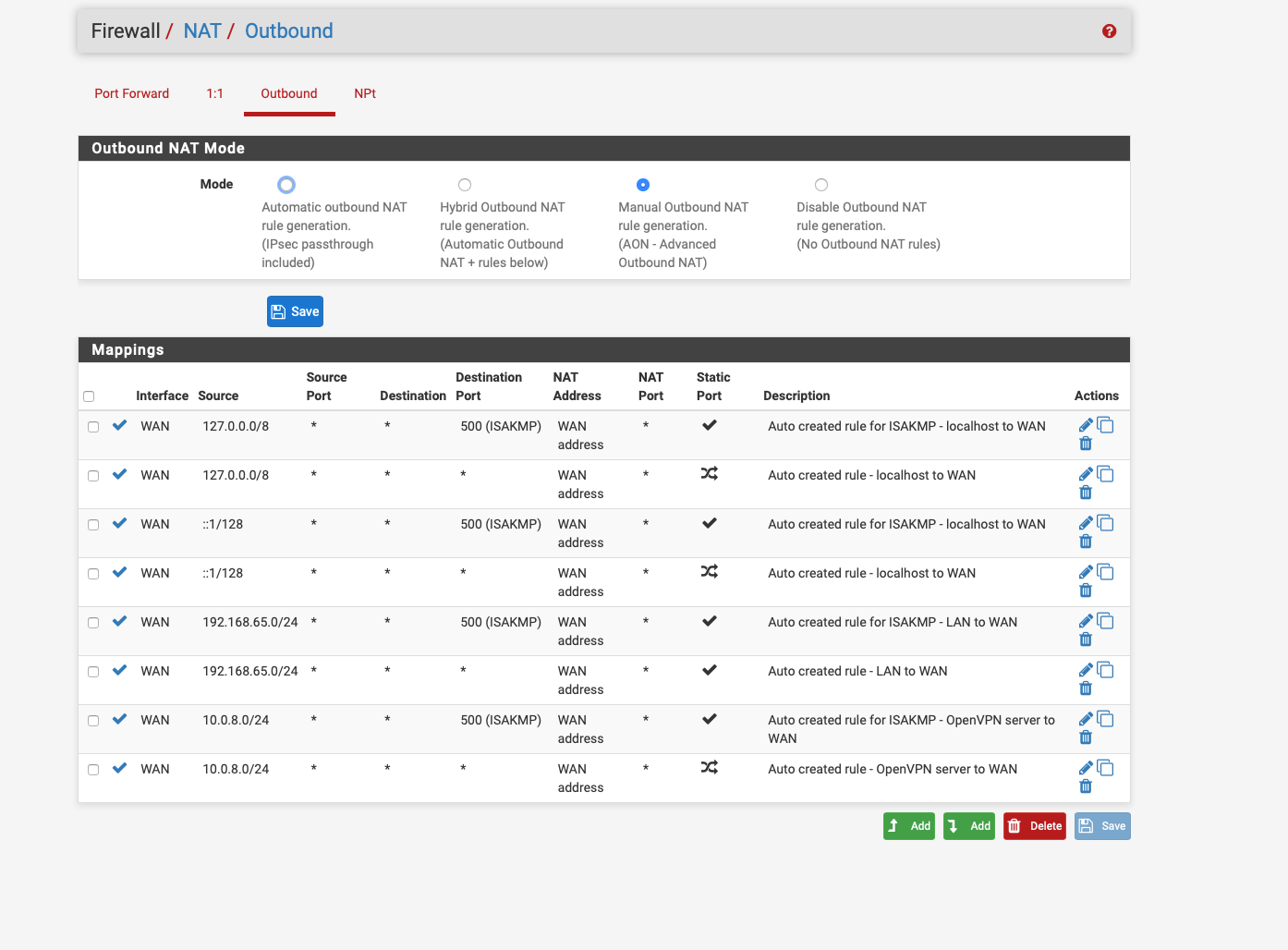

            I took the box back to my office and for some reason I haven't lost connection. That's rather strange. Anyhow, I have enabled SSH so should be able to get access to it.
            Attached is the NAT Outbound screenshot if you see anything odd.
            Tks a lot for spending some time on this.

              @beno44 Your main LAN->WAN outbound NAT rule (for the 192.168.65.0 net, the 3rd one up from the bottom) looks incorrect to me. It should not be set to static port.
              Do you need to use Manual NAT mode? Unless you really have a good reason for that, I suggest sticking to Hybrid or Automatic mode.

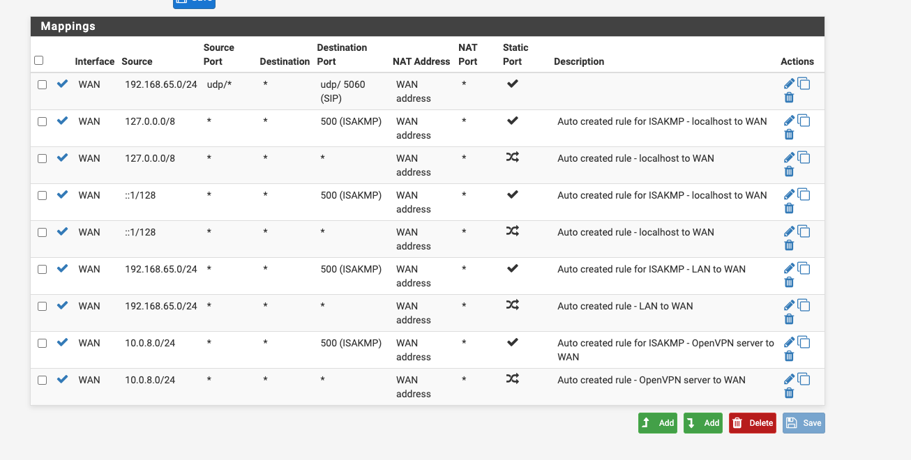

                        @beno44 that rule you made has a few problems that I can see:
                        • it needs to be higher up, otherwise the rules above it will match first and it will have no effect
                        • I doubt if you want the source port to be set to 5060. Source ports are usually randomized, the dport should be enough unless your VoIP provider has a very odd setup
                        • source of "any" is probably wrong too. I would make it match the LAN subnet that your phones are sitting on
                        B 1 Reply Last reply Reply Quote 1

                          @beno44 There wasn't much right...Tks again so much ;o)

                            @beno44 Looking much better!
