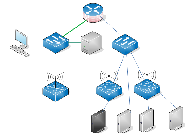

p.s. what are you using for these diagrams?

drawings are done with visio.
