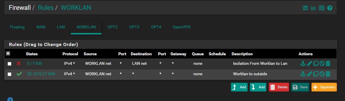

                  @stephenw10I have an IP range of my home LAN as 192.168.1.0/24. I enabled the opt1 phical port and renamed it to worklan and gave it a range of 192.168.55.0/24. Enabled DHCP to give out ip's at a range of 192.168.55.100 - 192.168.55.200.
                  However I think my firewall rules are wonky. I can ping from my laptop on the regular lan to 192.158.55.1.
                  This is a link to the rules https://ibb.co/vjCFZLm
                  I followed a guide and tried to cutomise it however, I do not think this is correct. I would like to isolate my LAN from my worklan and isolate worklan from LAN. Then have that worklan be connected to the express VPN.
                    akuma1x @BlackBirdWilliams
                    @blackbirdwilliams Your rules are setup incorrectly. To setup the isolation of one network from the other, here's what you want to do.
                    Make a new rule on the WORKLAN network, move it all the way up to the top of the list.
                    Action: Reject or Block - either one will work
                    Interface: WORKLAN
                    Address Family: IPv4
                    Protocol: any
                    Source: WORKLAN net
                    Destination: LAN net
                    Description: give it a good name here
                    SAVE
                    And you're done with that one. Make another rule, move it all the way down to the bottom after you are finished making it.
                    Action: Pass
                    Interface: WORKLAN
                    Protocol: any
                    Source: WORKLAN net
                    Destination: any
                    SAVE
                    And you're done with that one. The three rules you've already got in that WORKLAN interface you can disable for now, they are not necessary. You might want to reboot your pfsense box now, just to make sure everything in the firewall rule section sticks and states are reset.
                    To use the ExpressVPN connection on your WORKLAN network, you first have to get that setup as a new gateway on your pfsense box. Do you have that already done? We can work on that in a different response, later.
                    To get your LAN network working, and to block it from accessing the WORKLAN network, you would make the same 2 rules above, on the LAN network, just use LAN net as the source and the WORKLAN net as the destination. Make sense?
                    When you've got these rules created and the 2 network's firewall rules all cleaned up, put up some more screenshots, so we can see if everything is all setup properly. Also, you don't need to use an external site to host your screenshots, you can do that here on the forum. That way, nobody has to click a link and open another site just to see your images.
                    Hope that helps!

                        • B Offline
                          BlackBirdWilliams @akuma1x
                          @akuma1x I truly appreciate the help! I have followed your guide to setup the rules on the worklan.
                          However, I'm a little confused as to what I should add on the LAN rules side.
                          Action: Block
                          Interface: LAN
                          Protocol: any
                          Source: LAN net
                          Destination: WorkLAN net
                          SAVE
                          Is the above rule correct? What would be the second rule for the LAN side?

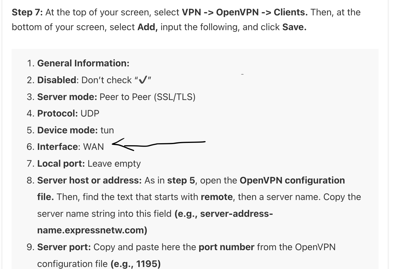

                            @blackbirdwilliams Also, I have openvpn setup to allow me to remote into the lan. Will this cause issues with setting up express VPN on the worklan side of things? BTW the Block rule I have added on the lan side, stops the ping from going through from the lan to worklan! Seems like it works after all! This is great.
                            Now I just need a little more guidance as to how to get express on the worklan. I have backup my settings at this point, just in case everything crashes and burns when I try to tweak the guide to fit my setup. Will keep you posted. Any tips would be greatly appreciated. Thank you for the help thus far!
                            B A 2 Replies Last reply Reply Quote 0
                            • B Offline
                              BlackBirdWilliams @BlackBirdWilliams
                              Would I change number 6. Interface to worklan? I don't want the express VPN to be on the LAN side. Not too sure how to customize this.

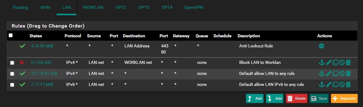

                                @blackbirdwilliams Here's what you setup on the LAN network:
                                Make a new rule on the LAN network, move it to the top, right under your anti-lockout rule.
                                Interface: LAN
                                Protocol: any
                                Source: LAN net
                                Destination: WORKLAN net
                                SAVE
                                Action: Pass
                                Interface: LAN
                                Protocol: any
                                Source: LAN net
                                Destination: any
                                SAVE
                                That second LAN rule should technically already be there, created automatically when pfsense is first setup. If you look at your LAN rules right away, after a fresh install, it says "Default allow LAN to any rule". It's rule number 2 in this screenshot:
                                So, long story short, sorry... If you simply create the first rule above (the LAN block rule), and move it into position #2 on your LAN network, you'll be all good to go.
                                Again, put up some screenshots, if you're comfortable with that, so we can check your rule settings.
                                • stephenw10S Online
                                  stephenw10 Netgate Administrator @BlackBirdWilliams
                                  @blackbirdwilliams said in netgate 5100:
                                  No. The OpenVPN client has to connect out of the WAN.
                                  As long as you have set 'do not pull routes' as shown in step 40 there nothing should change.
                                  Once you have that up you need to:
                                  Assign the OpenVPN client as an interface. This will give you a gateway to route to.
                                  Make sure the firewall default route is still via the WAN dhcp gateway. In System > Routing > Gateways, make sure the default gateway is set the WAN_DHCP not automatic.
                                  Add policy routing to the pass rule on WORKLAN to make that traffic go via the VPN.
                                  See: https://docs.netgate.com/pfsense/en/latest/vpn/openvpn/assign.html
                                  • B Offline
                                    @akuma1x I think I'm good to do with the rules. Here is a screenshotfirewallrules.jpg of the LAN side and worklan. worklan.jpg
                                        @blackbirdwilliams Yep, that's it, looks good!
                                        So, the ExpressVPN connection you're working on will go in your WORKLAN rule, in the "to outside" rule. When your VPN settings are all done and working, you simply add the VPN connection as your gateway in that rule, like @stephenw10 commented just above.
