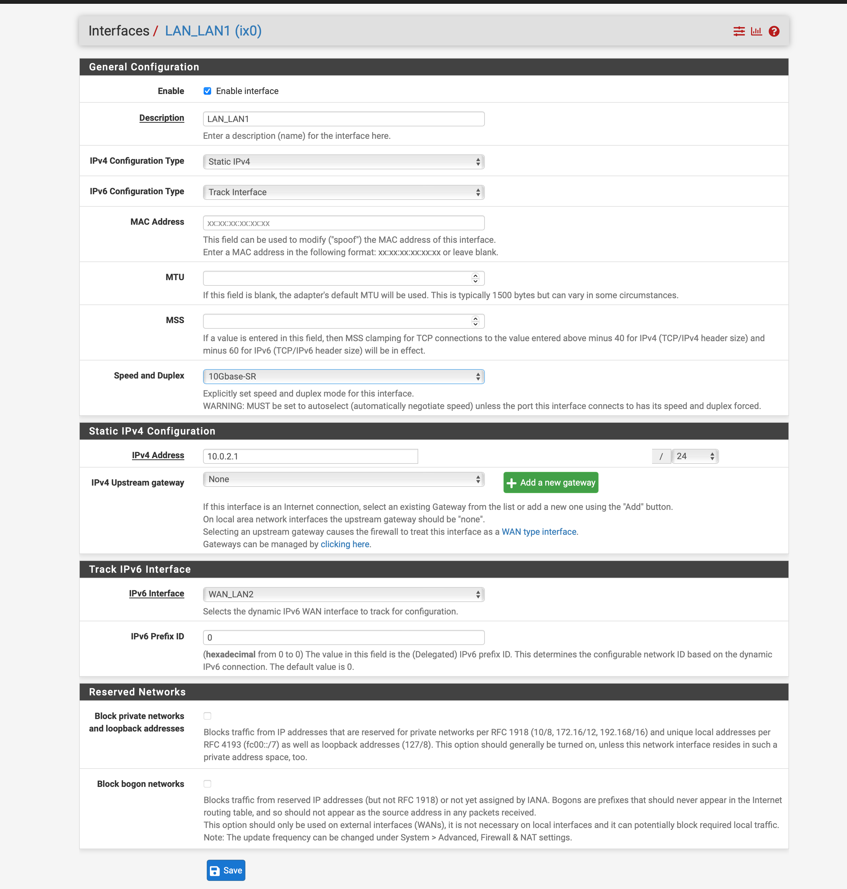

      Hey everyone, would really appreciate a second set of eyes on this, let me know if I did something wrong. Getting what seems like an odd msg regarding my LAN connection. (pls see bold question below)
      Installed an SFP module into a Netgate 6100 and Ubiquiti switch. Connected both with a Fiber Cable:
      Gear:
      Fiber Patch Cable - LC to LC OM3 10Gb/Gigabit Multi-Mode Jumper Duplex 50/125 LSZH Fiber Optic Cord for SFP Transceiver, Computer Fiber Networks
      SFP in the 6100
      10Gtek
      10GBase-SR SFP+ Transceiver, 10G 850nm MMF, up to 300 Meters, Compatible with Cisco SFP-10G-SR, Meraki MA-SFP-10GB-SR, Ubiquiti UniFi UF-MM-10G
      SFP in the Ubiquiti Switch
      Ubiquiti U Fiber Multi-Mode SFP 10G - UF-MM-10G
      Its working, but wondering if everything is correct, like maybe I used the wrong kind of cable?
      I see this on my dashboard:
      10Gbase-SR <full-duplex,rxpause,txpause>
      is the rxpause,txpause ok?
      Settings (its my LAN connection)
