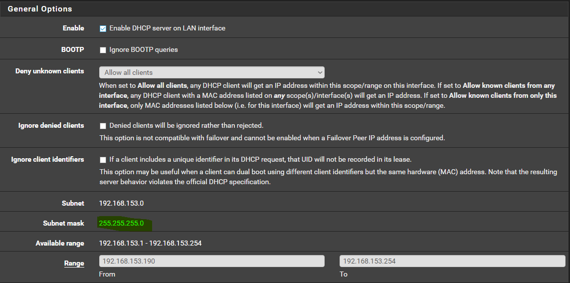

      I have a question: My LAN has a netmask 255.255.255.0. I have a DHCP server with a pool 192.168.0.1 and a range from 192.168.0.190 to 192.168.0.254
      Why the server is delivering addresses with a netmask 255.0.0.0?

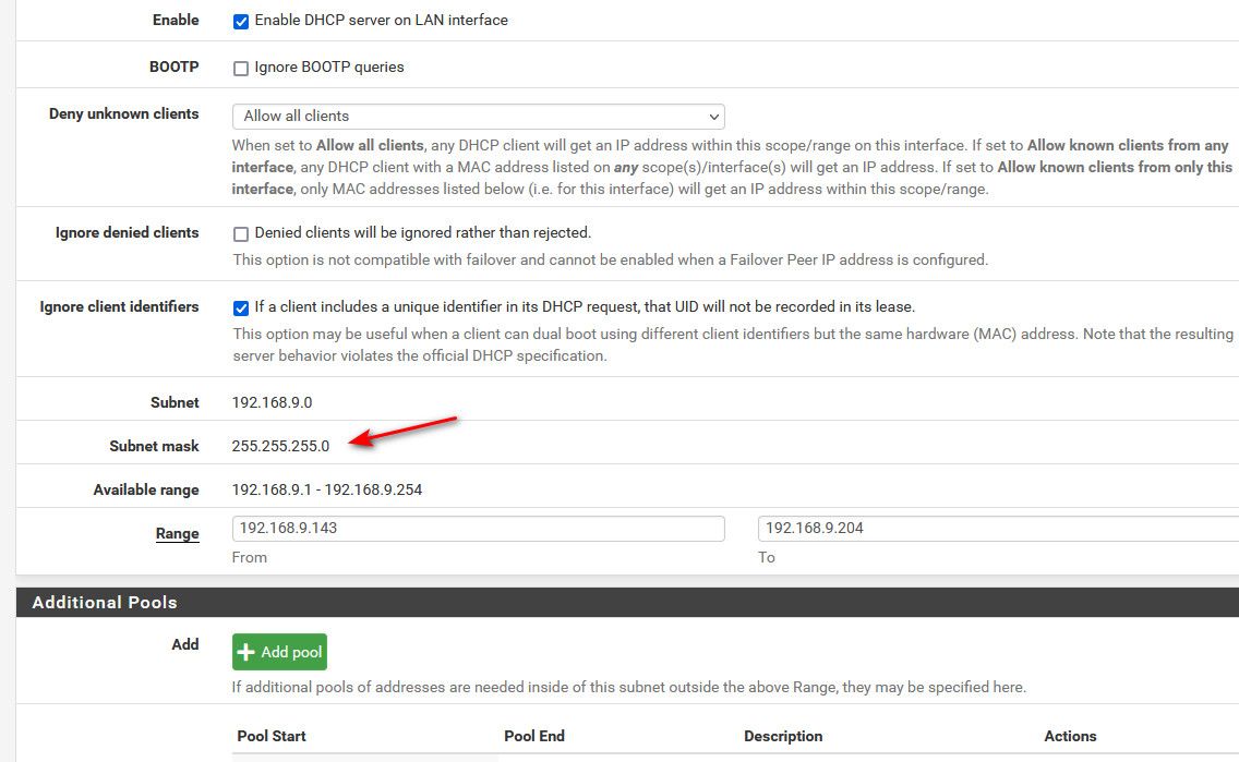

        johnpoz LAYER 8 Global Moderator @Reeko
        @reeko it wouldn't where exactly are you seeing this?
        So here is my lan dhcp..
        For validation sniff on your lan interface for dhcp and you can see exactly what is offered.
        example
        That is a different network than my lan, but wanted to show a dhcp exchange.. Was just easier to cycle the wifi on my phone to see a new request and what the dhcp server sent back.

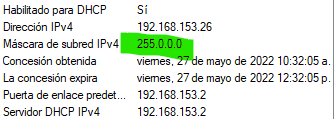

          Hi @johnpoz, thank you for the reply.
          My Pc is receiving that mask. My setup is like yours:
          I don't know if this is a bug or if I'm missing something here:
          What do you think?
          Greetings!

              Reeko @johnpoz
              @johnpoz Hi, there is no other DHCP server in the network. The IP 192.168.153.2 is the IP of my Pfsense server. I will sniff the net to check if there is a phantom dhcp around. No changes were made to the network.
              @johnpoz said in DHCP Server:
              Did it use to be 192/8
              No, actually it use to be 192/24

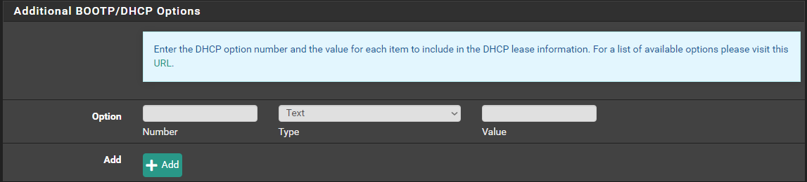

                                    Reeko @luckman212
                                    @luckman212 Hi there!
                                    Sorry, I was busy with other things.
                                    Apparently, the problem was this:
                                    There was a number in the "Number" field. I presume that number enabled an advanced option, altering the DHCP functionality. The number was a "1". I deleted that, saved the configuration, restarted the server and the DHCP server now is delivering addresses correctly: 255.255.255.0
                                    I forgot to use WireShark and sniff the network. That helped me a lot. Thank you for that @johnpoz

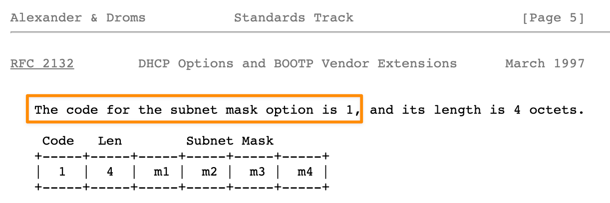

                                      luckman212 LAYER 8 @Reeko
                                      @reeko Ah ha. That makes sense. DHCP Option Code 1 specifies the subnet mask. So it of course could cause this issue. Nice troubleshooting! Glad you were able to solve it.
                                        Reeko @luckman212
                                        @luckman212 Oh! Now everything makes sense. Geez!
                                        Well, thank you for the information.
