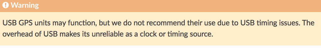

        @digitalgimpus Is the GPS device USB? If so, heed this warning from here: https://docs.netgate.com/pfsense/en/latest/services/ntpd/gps.htm
          digitalgimpus @NollipfSense
          @nollipfsense Negative, I should have mentioned that. It's a serial GPS.
