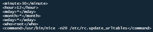

      What is causing minicron to call this
      php-fpm 359 /rc.update_alias_url_data: Configuration Change: (system): URL alias data updated via minicron
      at 2:18am every night when the only relevant entry in config.xml is set to the default 12:30:
      This is crucial because around the time this is called pfSense seems to stall and connectivity for all the machines behind it is interrupted. I'd like to change the time this happens, or ideally make it happen in a way that does not interrupt packet flow.
      /var/db/aliastables/ has a single entry in it. a file with less than 70 single IPs
        Install the cron package and change it. Or just edit the config file and reboot.

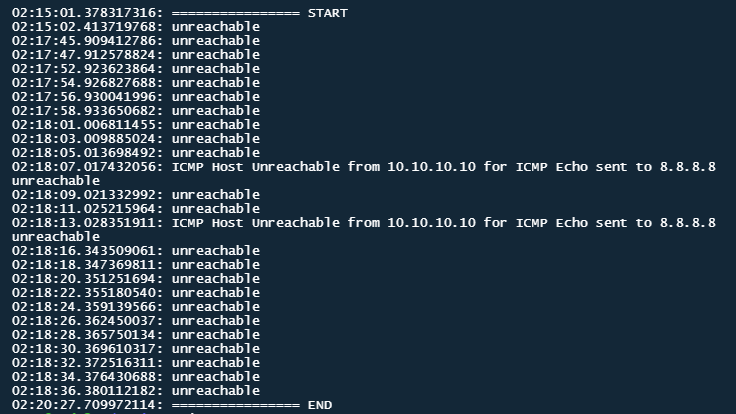

                            • pitchforkP Offline
                              pitchfork @stephenw10
                              It is possible that it harms performance for 30 to 40 seconds because if the application is offline for a few seconds it has to catch up with the lost time.
                              BUT I have done pings (one per second between 2:15 and 2:20) and there are several failures over that 30-40 sec time span:
                              the 02:15:02.413719768 can be ignored. it's a random failure. but the cluster from 02:17:45.909412786 to 02:18:36.380112182 is when the outage occurred.
