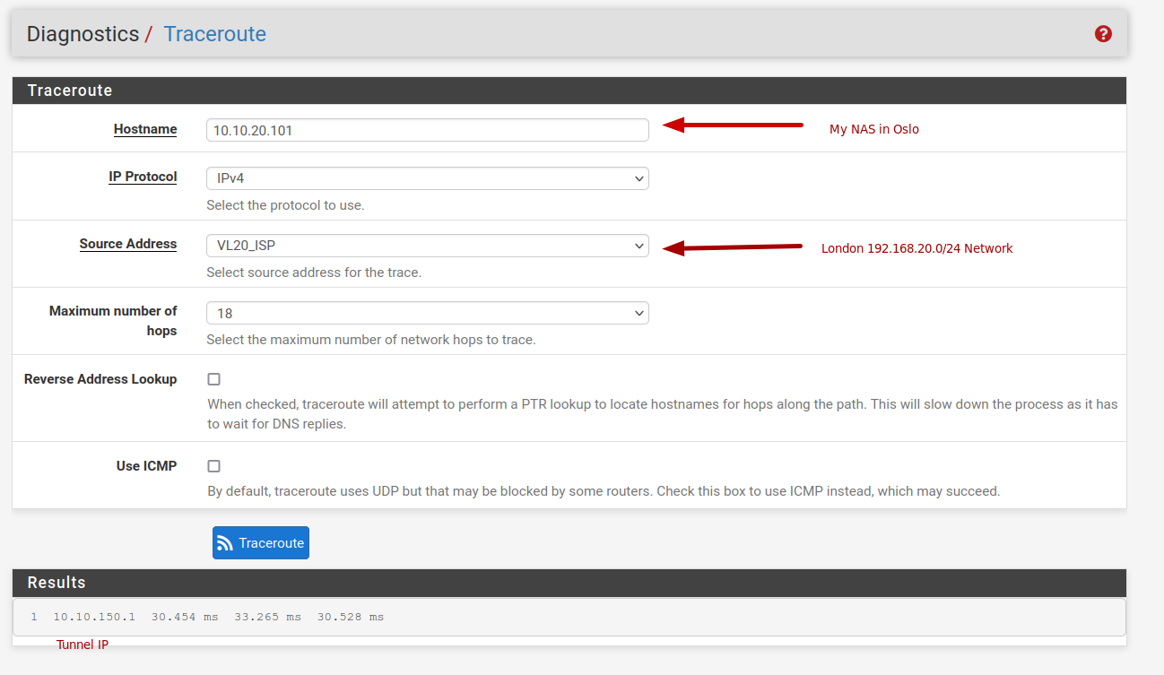

                                  So I'm connecting to my NAS in Oslo from London

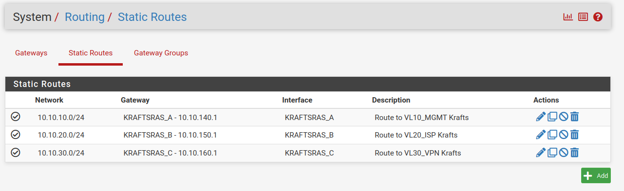

                                  These are my routes from London to Oslo, it seems to work ok, and vice versa in Oslo.
                                  This all works quite ok, just struggling to achieve 2 hops when I connect remotely, I know I have missed something simple ...

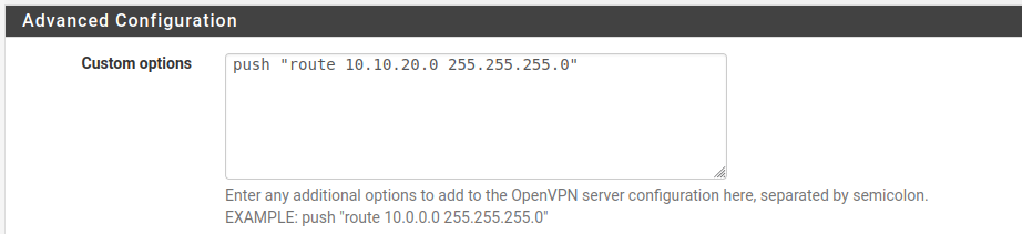

                                  I had thought in the past a possible solution was to add in the Advanced Configuration > Custom options part of the OpenVPN server configuration, - push “route 10.10.20.0 255.255.255.0” - it did not work.
