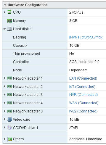

            I'm not really too familiar with ESXi but it looks like it's not running as a thin disk? I know FreeBSD can choke on that though not with that error normally.
            No updates in the hypervisor?

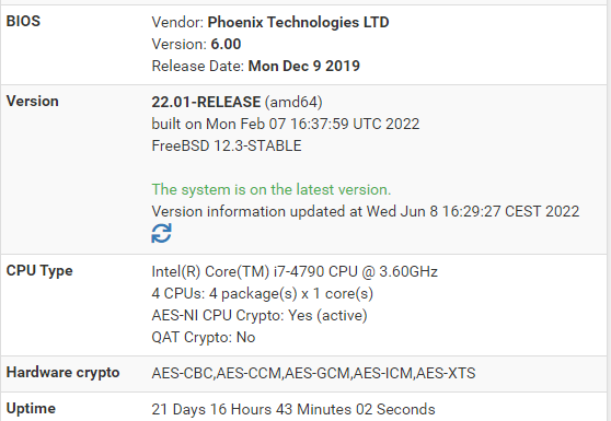

            • P Offline
              psp
              I have one istance of v22.01 running in production on ESXi-7.0U3d-19482537-standard and one on ESXi-6.7.0-20191204001-standard. No issues, thick provisioned.

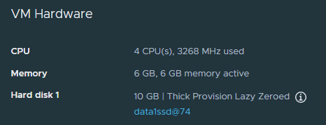

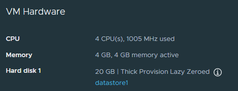

                  Both installs are running as Thick Provision Lazy Zeroed.
                  The first install is having no issues at all.
                  Site A
                  Site B
                  Nothing special in hypervisor. Machine is going to a reboot. No high disk writes/reads or anything.

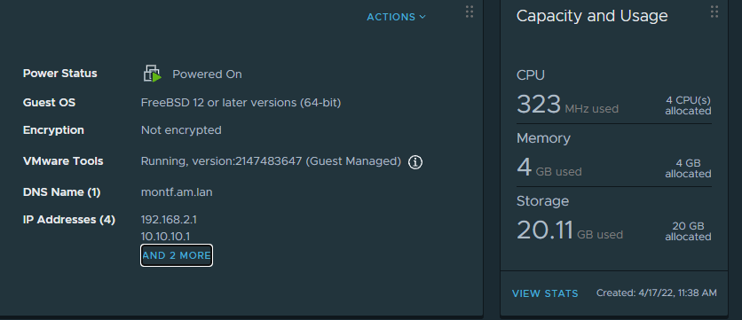

                    Same host on each site? Same VM settings?
                    • jimpJ Offline
                      What VM hardware version are you running on those VMs? Usually weird/unexplained instability and panics like that are from running a VM hardware version (or ESX version) not fully compatible with the version of FreeBSD used on the guest.
                      I no longer use ESX here (moved everything to Proxmox VE) so I can't speak to how things work on recent versions of ESX or specific VM hardware versions, but generally speaking it's safest to upgrade them to the most recent available VM hardware version. Sometimes with a much newer base/ESX it might not be a bad idea to keep it on an older version but that situation is more rare.
