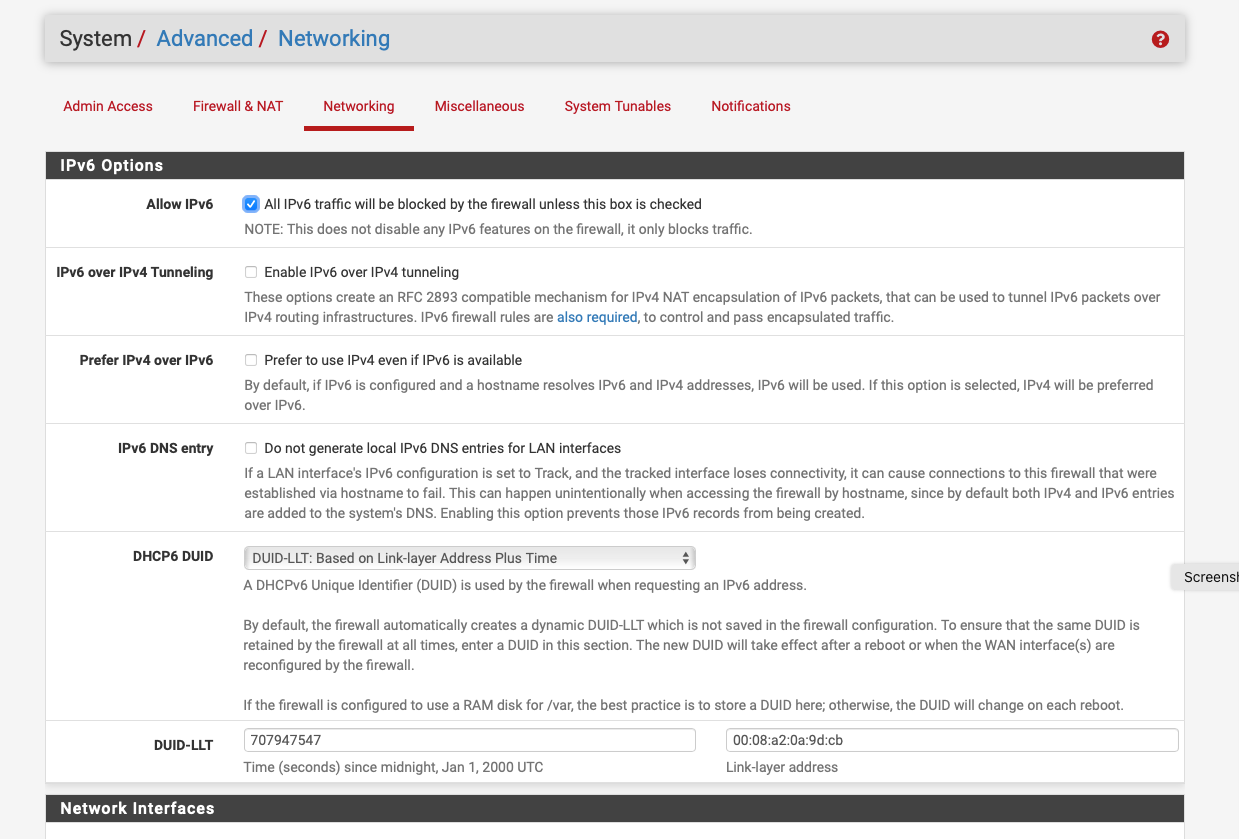

                      @s_d Think Zen may have had an issue with the DHCP6 DUID.
                      Changed the DUID type, did a save then changed the DUID type back, effectively creating a new DUID-LLT and its now working as it should with the PD set to /48.
                      Andy
