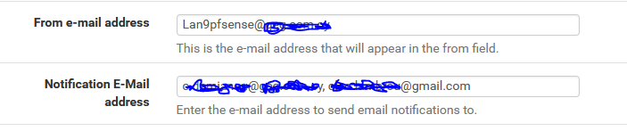

      i need to add a second email address under advanced, notifications.
      it seems that only the first email is working, when i add the second email separate by comma and space. Is there any way to do that ? or not supported yet ?

              @stephenw10 semicolon not working, returns an error.
              comma "," not return error but is not sending the email. I'm on Version 2.6

                      still not working, i'm suspecting the email provider is not supporting multiple receipients. what is suggested to use ?
