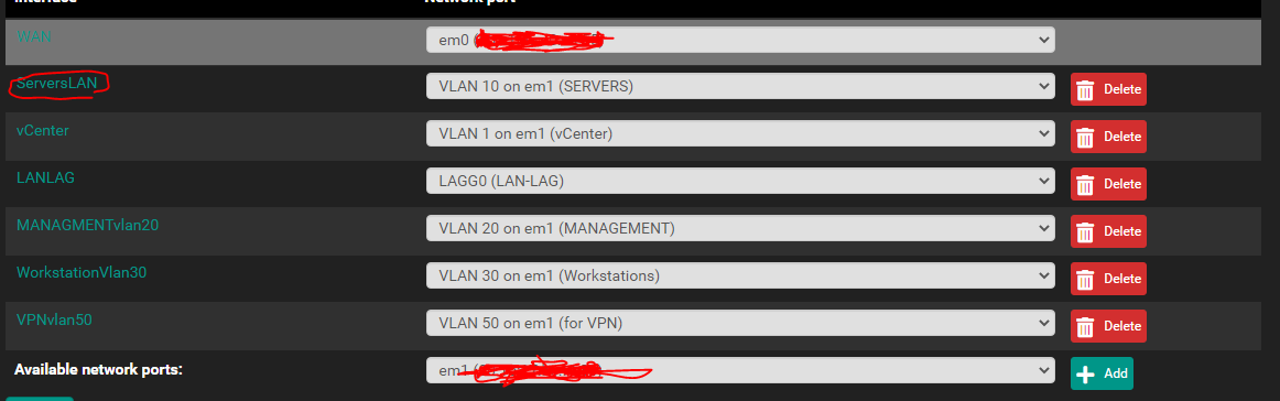

        I read before that the DHCP relay is work on LAN adapter which on my side is em.1 but my workstation vlan 3 is virtual and is a assign to this physical port. Is it be possible the relay to work only with LAN and is need to be reconfigured via command line to relayed to virtual - here may be my question is silly but have no idea how to resolved this issue i fight with this more than a couple a week.
        here is the assigment of the adapters virtual and physical: like serverlan is original LAN by default i re-name it.

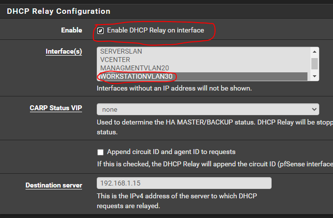

          @hris
          The DHCP Realy settings:
