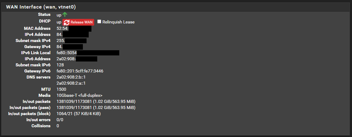

      I wanted to start with configuring the WAN interface for IPv6 only at first. Assuming it would not break anything. So no DHCP6 server is running on the the LAN interface. Unfortunately, if I activate DHCP6 on the WAN interface it breaks the whole routing between WAN and LAN. ๐Ÿ˜ข
      Here you can see, that my ISP has provided an IPv6 address:
      This the WAN interface DHCP configuration:

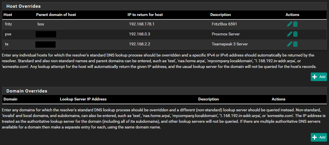

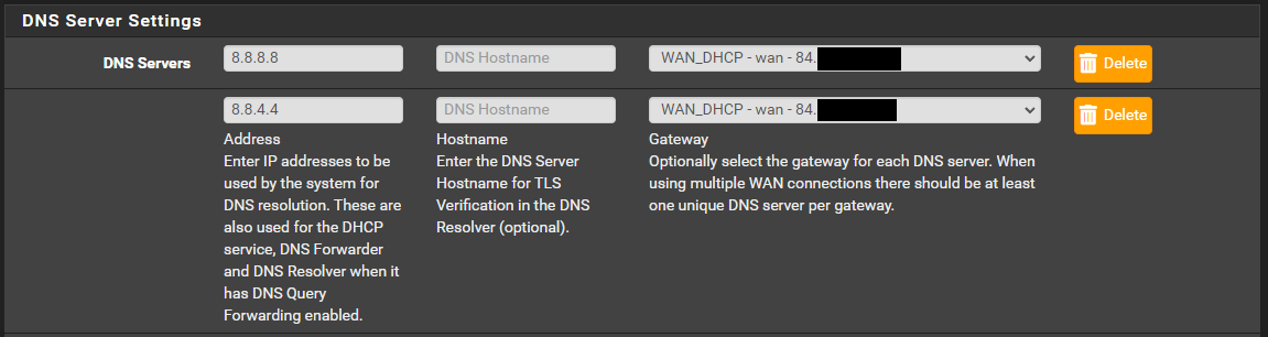

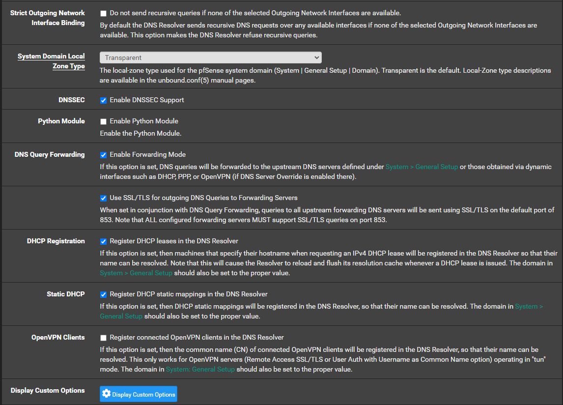

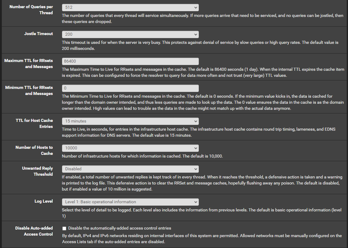

                What are your DNS Resolver settings?
                Here are my settings:
                20220613_DNS_Resolver_Settings_0.png 20220613_DNS_Resolver_Settings_1.png20220613_DNS_Resolver_Settings_2.png20220613_DNS_Resolver_Settings_3.png20220613_DNS_Resolver_Settings_4.png20220613_DNS_Resolver_Settings_5.png20220613_DNS_Resolver_Settings_6.png

                    @m0nkey is there a reason you enabled forwarding mode?
                    • M
                      m0nKeY @heper
                      @heper I'm not sure anymore. I guess I had activated it because I was experimenting with certificate offloading for my sub-services.
                      But basically, I don't know. Should I try to deactivate it?

                          • S
                            SteveITS Galactic Empire @m0nKeY
                            @m0nkey You might try unchecking:
                            Use SSL/TLS for outgoing DNS Queries to Forwarding Servers
                            DNSSEC data is required for trust-anchored zones.
                            Pre-2.7.2/23.09: Only install packages for your version, or risk breaking it. Select your branch in System/Update/Update Settings.
                            When upgrading, allow 10-15 minutes to restart, or more depending on packages and device speed.
                            Upvote ๐Ÿ‘ helpful posts!
                            • M
                              m0nKeY @SteveITS
                              @steveits Thx, unchecked them, but it does not solve my problem. ๐Ÿ˜Ÿ
