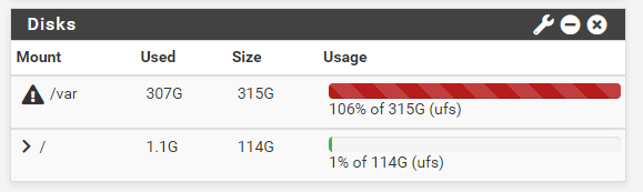

Hello,
We are running pfsense "2.6.0-RELEASE" and have noticed our /var is out of space. How can I expand /var or make more space in /var?
Thank you for your help!
You don't, you find out what's using all the space and delete it. Nothing should use anything approaching that much drive space in pfSense. You have something that is incorrectly using it. Probably logs that are not rotating as expected and that's usually Snort or Suricata.

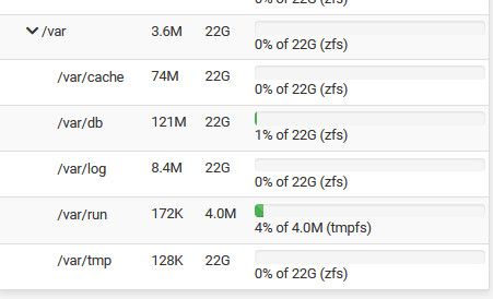

@stephenw10 I was going to say - wow, my var isn't using anything close to that ;)
on a side note I take it you did an upgrade to 2.6 vs clean - didn't zfs become the new default file system? Notice your still using ufs
