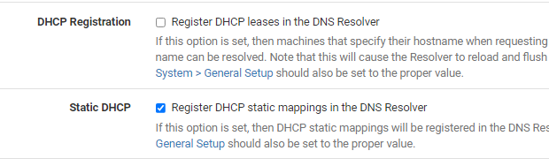

        If you have checked the box in the DHCP Server settings for it to update DNS with client hostnames when issuing/renewing a DHCP lease, then you will cause DNS problems in your network. That's because currently the DHCP server daemon on pfSense will restart the unbound daemon that underpins the DNS Resolver each time a DHCP lease updates. That restart means DNS lookups don't happen while unbound is restarting.
        Also, if you are using pfBlockerNG-devel and its DNSBL feature, that further exacerbates the problem because large DNS blocklists take a long time to parse and load, so the DNS Resolver takes longer to start up.
        Are you using DNSBL with Python mode enabled? If not, then check the DHCP setting I mentioned first. Uncheck that if checked. Also see if the DNS Resolver has stopped when you are having DNS issues. The system log in pfSense can be a help here.

          DHCP client hostname update was already disabled.
          I have also now disabled registering static mappings in case that caused any problems.

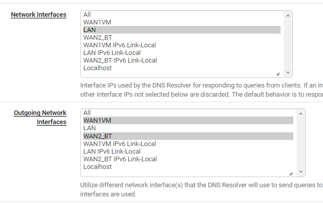

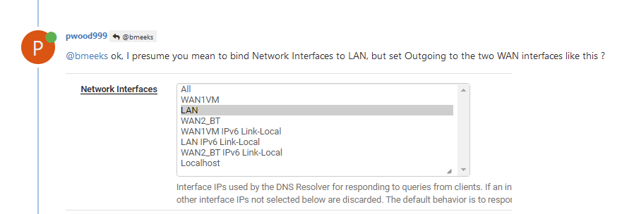

                          @bmeeks ok, I presume you mean to bind Network Interfaces to LAN, but set Outgoing to the two WAN interfaces like this ?
                          What about my OpenVPN server ? This is tied to localhost, but has inbound port forwards from both WAN modems.

                          • bmeeksB Offline
                            bmeeks @pwood999
                            @pwood999 said in Strange DNS Issue for all clients:
                            Never mind what I said before. I don't believe what I was thinking is possible since the Resolver wants to be explicitly told which outgoing interfaces to use. I had forgotten about the Outgoing Network Interfaces section when I first replied.
                            In your case I would just leave those settings at the default which is "All".
                              Gertjan @pwood999
                              @pwood999
                              Be careful with that setting "Network interfaces : LAN ( and only LAN ).
                              You saw the 'Localhost' at the bottom of the list ? You've omitted to select that one.
                              Result : pfSense itself, that is, code like the GUI, will consult what that IP. Not the LAN, not the WAN.
                              Local software, like on your phone and PC will consult always 127.0.0.1 or Localhost or ::1
                              On localhost, port 53, is running a local DNS 'collector' that will forward to an (that's what a typical Windows PC does) upstream router. As per instructiosn by the local DHCP server (pfSense) and the local DHCP client your your PC.
                              Type
                              ipconfig /all
                              to see your local DNS setting : it's most probably 192.168.1.1 == the LAN IP of pfSense and pSense is (should !) listen on that interface.
                              Actually, it's a no brainer : just keep "All" selected for both "Network Interfaces" and "Outgoing Network Interfaces". That's the default settings, created by Netgate after years of investigation.
                              It's not an issue that unbound is listing on some WAN type interface : nothing can come into the WAN anyway.
                              And before you say : but that is dangerous !!
                              Don't worry. It' looks scary because you think it's scary.
                              The Web server GUI nginx is also listing on All available interfaces ( but don't tell any body, as you might wake up the thin foil hat association )
                              [22.01-RELEASE][root@pfSense.mypfsense.net]/root: sockstat -4l | grep 'nginx'
                              root     nginx      98071 5  tcp4   *:443                 *:*
                              root     nginx      98071 6  tcp6   *:443                 *:*
                              root     nginx      98071 7  tcp4   *:80                  *:*
                              root     nginx      98071 8  tcp6   *:80                  *:*
                              root     nginx      97984 5  tcp4   *:443                 *:*
                              root     nginx      97984 6  tcp6   *:443                 *:*
                              root     nginx      97984 7  tcp4   *:80                  *:*
                              root     nginx      97984 8  tcp6   *:80                  *:*
                              root     nginx      97740 5  tcp4   *:443                 *:*
                              root     nginx      97740 6  tcp6   *:443                 *:*
                              root     nginx      97740 7  tcp4   *:80                  *:*
                              root     nginx      97740 8  tcp6   *:80                  *:*
                              which means : listen on every interface for every 443 and 80 using TCP.
                              Every interface == "All".
