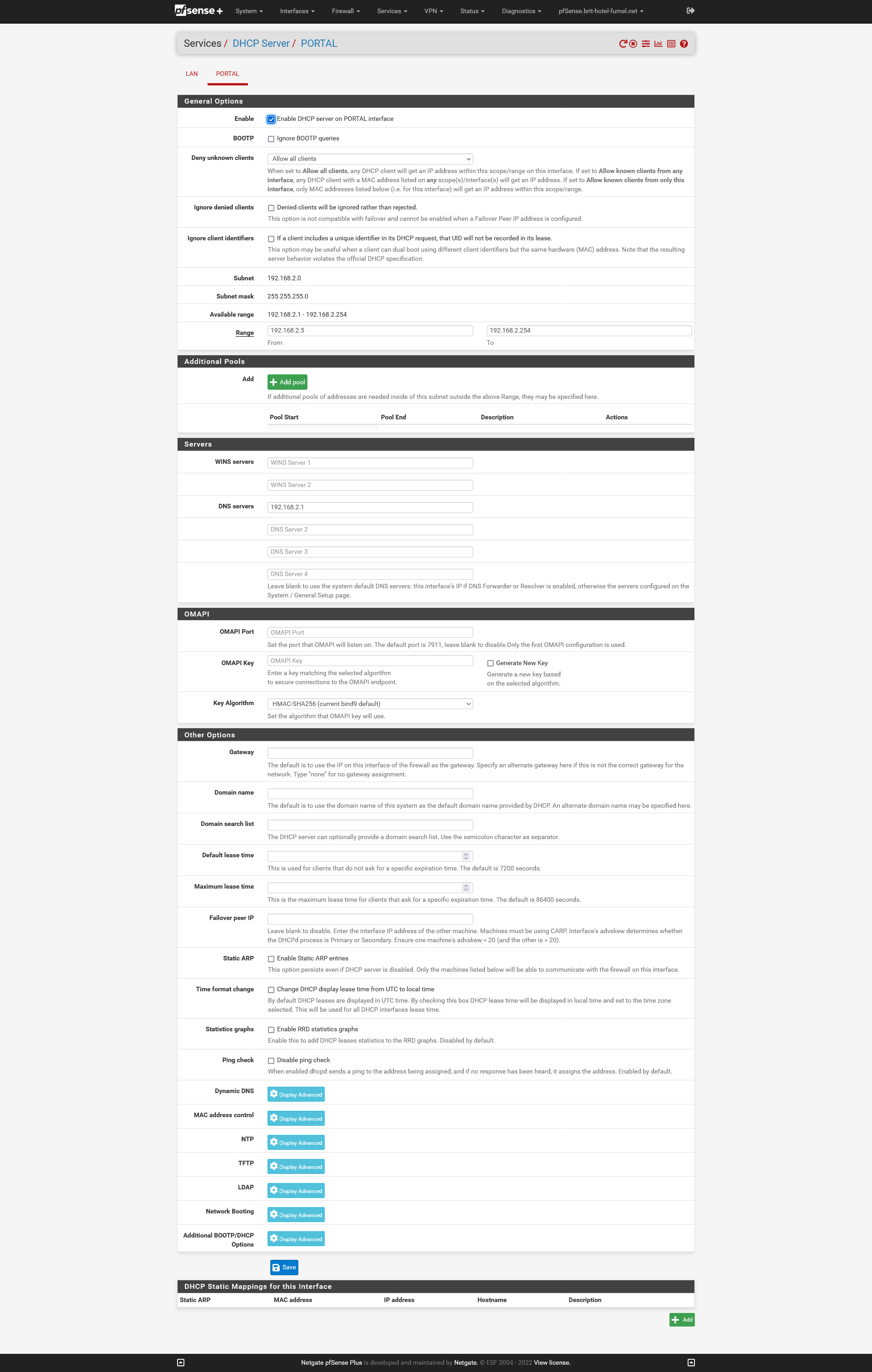

            These are the settings of the DHCP server of my 'PORTAL' network, 192.168.2.0/24 :
            I did set 192.168.2.1 as the DNS server. I'm not sure if that is actually needed, if pfSense is the networks DNS also.
            Unbound (pfSense) is listening on that interface.
            Debugging the DHCP session on te user side : it gets an DNS server.
            ipfw firewall rules do permit DNS traffic, even when the device isn't logged into the portal yet.
